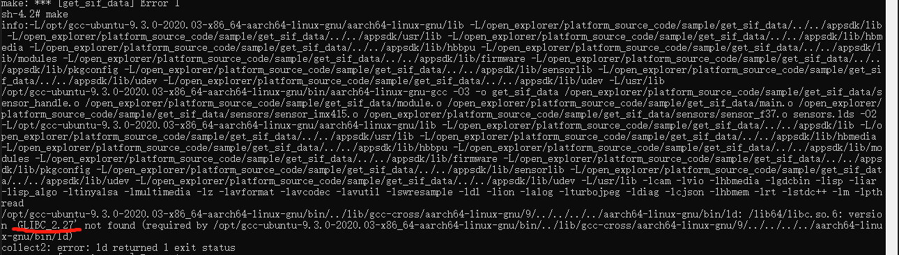

采用docker安装centos2.0.4和centos2.2.3镜像,安装交叉编译环境,在交叉编译环境中编译get_sif_data, 会报错“/lib64/libc.so.6: version `GLIBC_2.27’ not found ”如下图,然后Makefile.param中,库的查找路径一部分在appsdk中也没有!
添加以下命令:
export LD_LIBRARY_PATH=/opt/gcc-ubuntu-9.3.0-2020.03-x86_64-aarch64-linux-gnu/lib/x86_64-linux-gnu:$LD_LIBRARY_PATH
