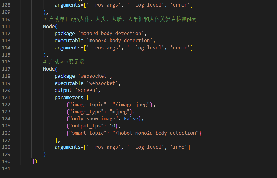

改MIPI摄像头调用为USB摄像头不成功

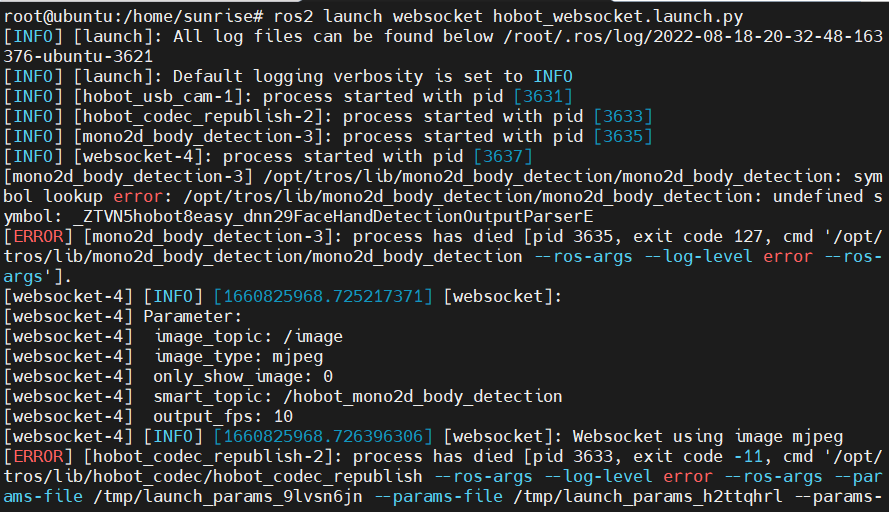

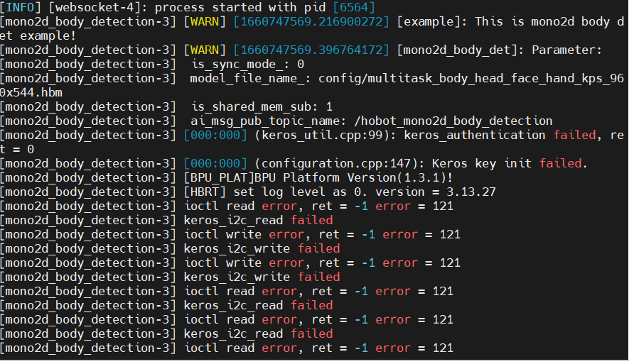

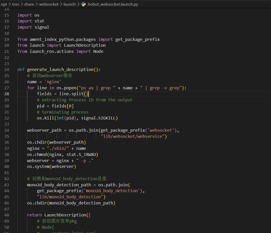

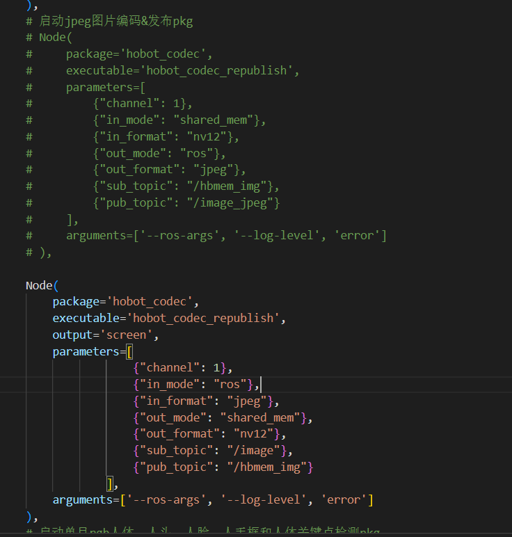

运行如下命令报错没有F37,然后按照论坛代码进行修改,依然报错,IP网页端无画面。

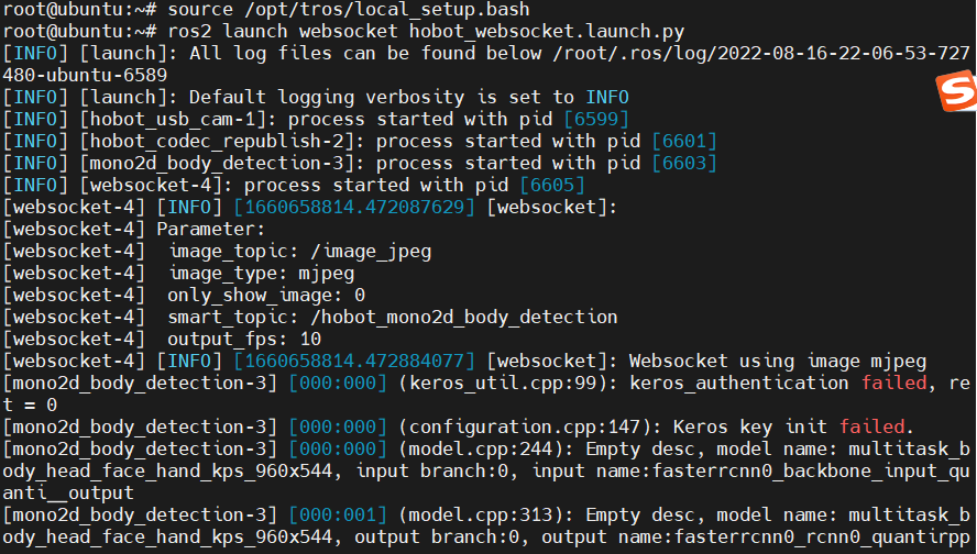

web展示端 image_topic 后面是/image

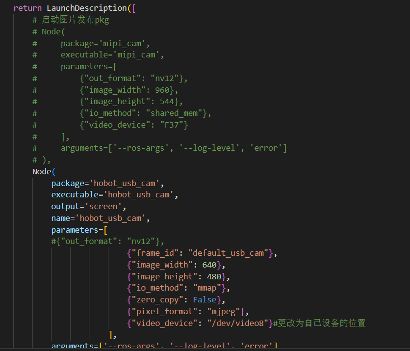

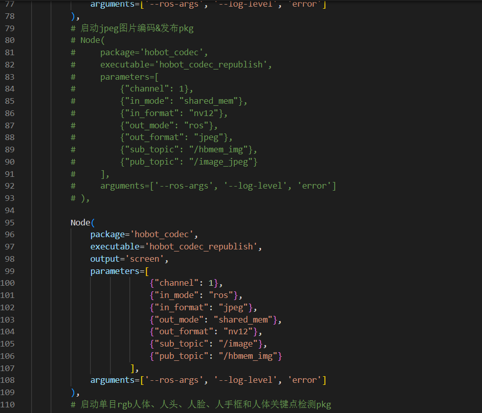

你好,麻烦把修改后的启动脚本文件发下,看起来像是改之后的脚本格式不太对。
改了还是一样,keros fail 和 log-lever error
麻烦把改之后的启动脚本内容发一下,我用你的脚本跑下看看,确认下哪里的格式出错了,从截图没看出来什么问题。

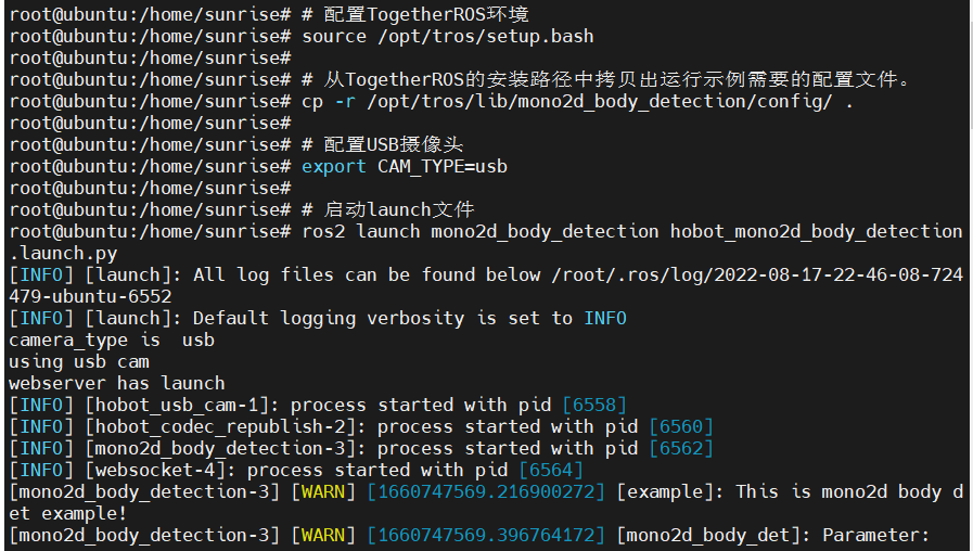

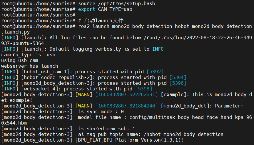

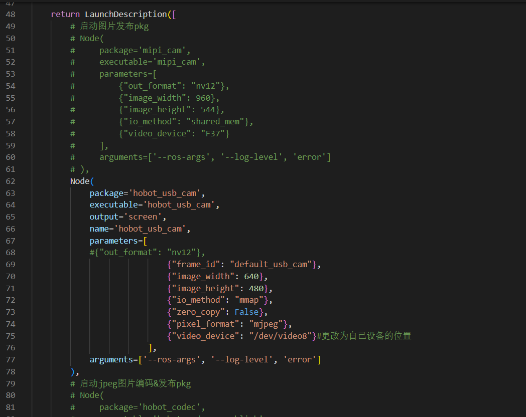

也可以使用下面这个启动脚本运行,选择USB摄像头,具体方法是:
# 配置TogetherROS环境source /opt/tros/setup.bash# 从TogetherROS的安装路径中拷贝出运行示例需要的配置文件。cp -r /opt/tros/lib/mono2d_body_detection/config/ .# 配置USB摄像头export CAM_TYPE=usb# 启动launch文件ros2 launch mono2d_body_detection hobot_mono2d_body_detection.launch.py
脚本内容:
import osfrom launch import LaunchDescriptionfrom launch_ros.actions import Nodefrom launch.actions import IncludeLaunchDescriptionfrom launch.launch_description_sources import PythonLaunchDescriptionSourcefrom ament_index_python import get_package_share_directoryfrom ament_index_python.packages import get_package_prefixdef generate_launch_description():    web_service_launch_include = IncludeLaunchDescription(        PythonLaunchDescriptionSource(            os.path.join(                get_package_share_directory('websocket'), 'launch/hobot_websocket_service.launch.py'))    ) # mipi cam图片发布    mipi_node = Node( package='mipi_cam', executable='mipi_cam', output='screen', parameters=[            {"out_format": "nv12"},            {"image_width": 960},            {"image_height": 544},            {"io_method": "shared_mem"},            {"video_device": "F37"}        ], arguments=['--ros-args', '--log-level', 'error']    ) # usb cam图片发布    usb_node = Node( package='hobot_usb_cam', executable='hobot_usb_cam', name='hobot_usb_cam', parameters=[                    {"frame_id": "default_usb_cam"},                    {"image_height": 480},                    {"image_width": 640},                    {"zero_copy": False},                    {"video_device": "/dev/video8"}                    ], arguments=['--ros-args', '--log-level', 'error']    ) # nv12->jpeg图片编码&发布    jpeg_codec_node = Node( package='hobot_codec', executable='hobot_codec_republish', output='screen', parameters=[            {"channel": 1},            {"in_mode": "shared_mem"},            {"in_format": "nv12"},            {"out_mode": "ros"},            {"out_format": "jpeg"},            {"sub_topic": "/hbmem_img"},            {"pub_topic": "/image"}        ], arguments=['--ros-args', '--log-level', 'error']    ) # jpeg->nv12图片解码&发布    nv12_codec_node = Node( package='hobot_codec', executable='hobot_codec_republish', output='screen', parameters=[            {"channel": 1},            {"in_mode": "ros"},            {"in_format": "jpeg"},            {"out_mode": "shared_mem"},            {"out_format": "nv12"},            {"sub_topic": "/image"},            {"pub_topic": "/hbmem_img"}        ], arguments=['--ros-args', '--log-level', 'error']    ) # 单目rgb人体、人头、人脸、人手框和人体关键点检测算法    mono2d_body_det_node = Node( package='mono2d_body_detection', executable='mono2d_body_detection', output='screen', parameters=[            {"ai_msg_pub_topic_name": "/hobot_mono2d_body_detection"}        ], arguments=['--ros-args', '--log-level', 'warn']    ) # web展示    web_node = Node( package='websocket', executable='websocket', output='screen', parameters=[            {"image_topic": "/image"},            {"image_type": "mjpeg"},            {"smart_topic": "/hobot_mono2d_body_detection"}        ], arguments=['--ros-args', '--log-level', 'error']    )    camera_type = os.getenv('CAM_TYPE') print("camera_type is ", camera_type)    cam_node = mipi_node    camera_type_mipi = True if camera_type == "usb": print("using usb cam")        cam_node = usb_node        camera_type_mipi = False elif camera_type == "mipi": print("using mipi cam")        cam_node = mipi_node        camera_type_mipi = True else: print("invalid camera_type ", camera_type, ", which is set with export CAM_TYPE=usb/mipi, using default mipi cam")        cam_node = mipi_node        camera_type_mipi = True if camera_type_mipi: return LaunchDescription([            web_service_launch_include, # 图片发布            cam_node, # 图片编解码&发布            jpeg_codec_node, # 启动算法            mono2d_body_det_node, # 启动web展示            web_node        ]) else: return LaunchDescription([            web_service_launch_include, # 图片发布            cam_node, # 图片编解码&发布            nv12_codec_node, # 启动算法            mono2d_body_det_node, # 启动web展示            web_node        ])
这个适配脚本计划在1.0.5版本(9月初)正式释放。

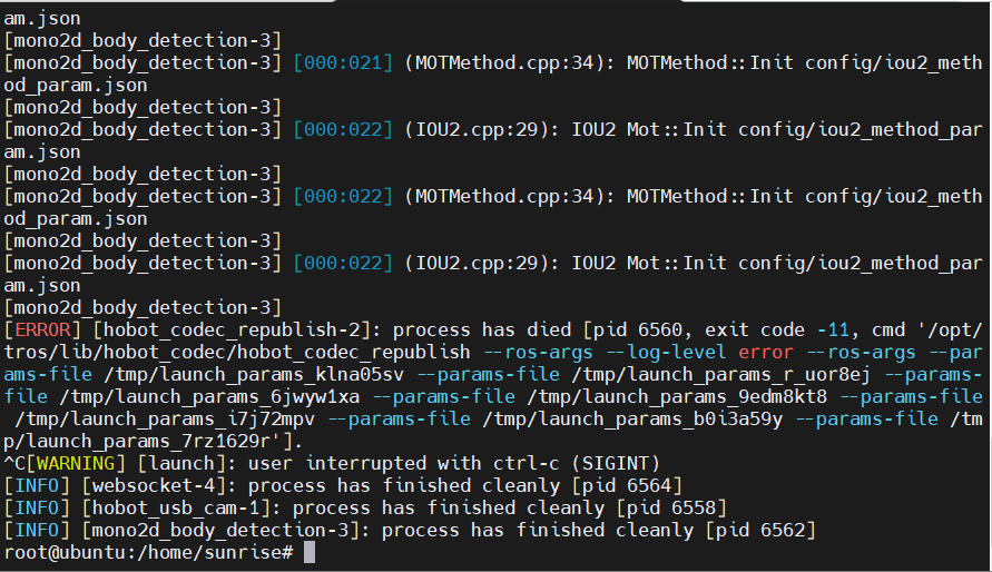

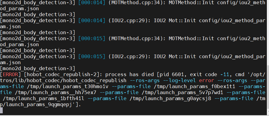

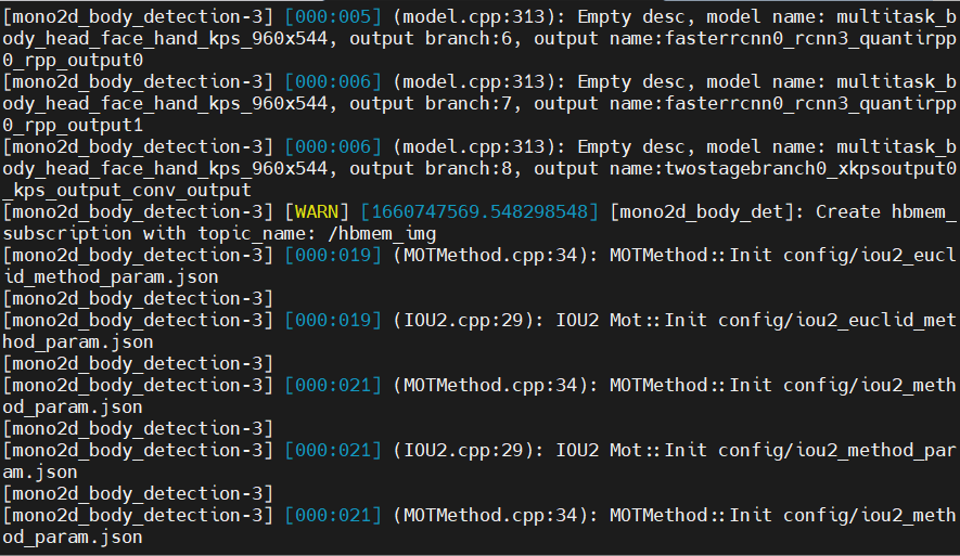

按照上述代码更改tros/share下相应py有仍有以下问题
省略正常输出

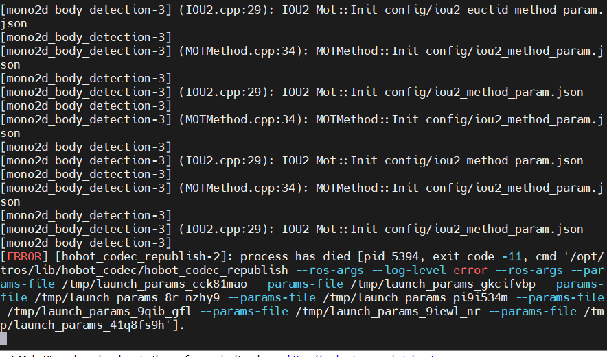

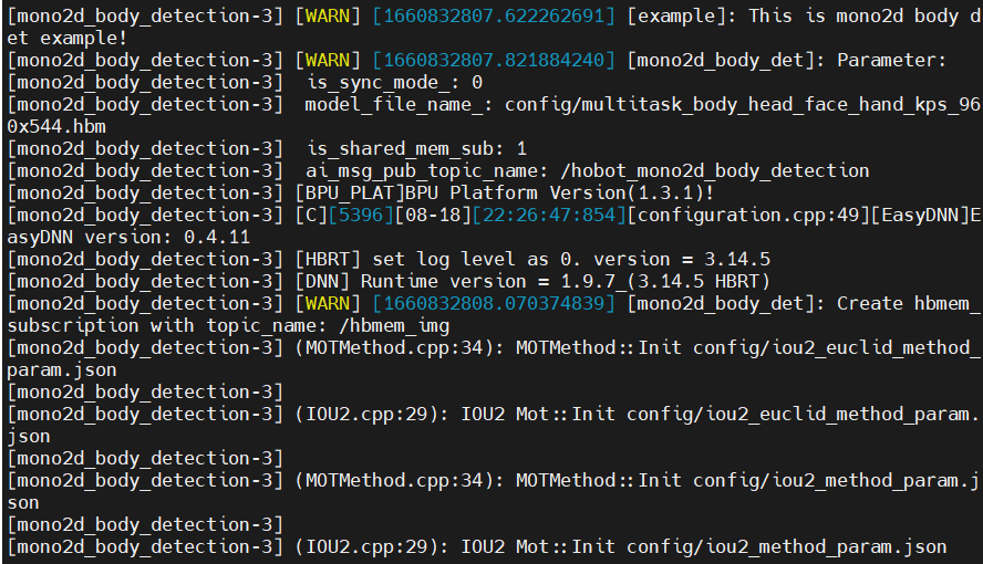

更新完最新的hhp之后仍有如下报错
source /opt/ros/foxy/setup.bash
不好意思,这个又有新的报错了
