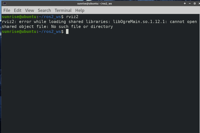

  1. 系统软件版本:x3_ubuntu_v1.1.5
  2. 问题涉及的技术领域: 操作系统、驱动
  3. 问题描述:在x3派裡執行rviz2時顯示rviz2: error while loading shared libraries: libOgreMain.so.1.12.1: cannot open shared object file: No such file or directory

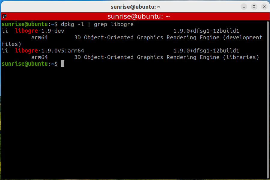

  4. 看了一下好像x3派裡的版本是ii libogre-1.9-dev 1.9.0+dfsg1-12build1 arm64 3D Object-Oriented Graphics Rendering Engine (development files)
  5. ii libogre-1.9.0v5:arm64 1.9.0+dfsg1-12build1 arm64 3D Object-Oriented Graphics Rendering Engine (libraries)

sunrise@ubuntu:~$ rviz2
  1. rviz2: error while loading shared libraries: libOgreMain.so.1.12.1: cannot open shared object file: No such file or directory

你好,X3本身不带gpu,所以无法做rviz显示,可以在pc上实现此功能,一个网段内支持显示的
好的,謝謝指導
