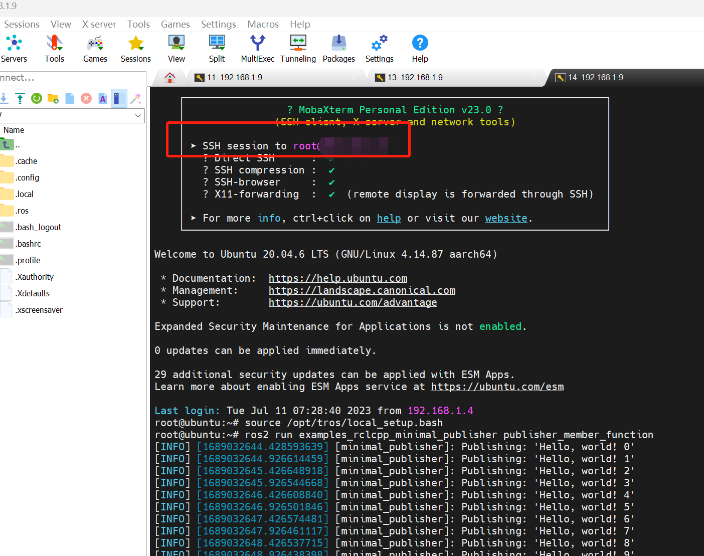

用SHH登录时运行可以
root@ubuntu:~# source /opt/tros/local_setup.bash
root@ubuntu:~# ros2 run examples_rclcpp_minimal_publisher publisher_member_function
[INFO] [1689032644.428593639] [minimal_publisher]: Publishing: ‘Hello, world! 0’
[INFO] [1689032644.926614459] [minimal_publisher]: Publishing: ‘Hello, world! 1’
[INFO] [1689032645.426648918] [minimal_publisher]: Publishing: ‘Hello, world! 2’
[INFO] [1689032645.926544668] [minimal_publisher]: Publishing: ‘Hello, world! 3’
[INFO] [1689032646.426608840] [minimal_publisher]: Publishing: ‘Hello, world! 4’
[INFO] [1689032646.926501846] [minimal_publisher]: Publishing: ‘Hello, world! 5’
[INFO] [1689032647.426574481] [minimal_publisher]: Publishing: ‘Hello, world! 6’
[INFO] [1689032647.926461117] [minimal_publisher]: Publishing: ‘Hello, world! 7’
[INFO] [1689032648.426537715] [minimal_publisher]: Publishing: ‘Hello, world! 8’
[INFO] [1689032648.926438398] [minimal_publisher]: Publishing: ‘Hello, world! 9’
你好,需要在root账户下运行
