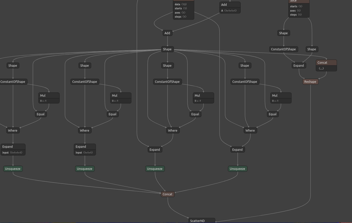

As shown in the following figure, int64 is not supported
