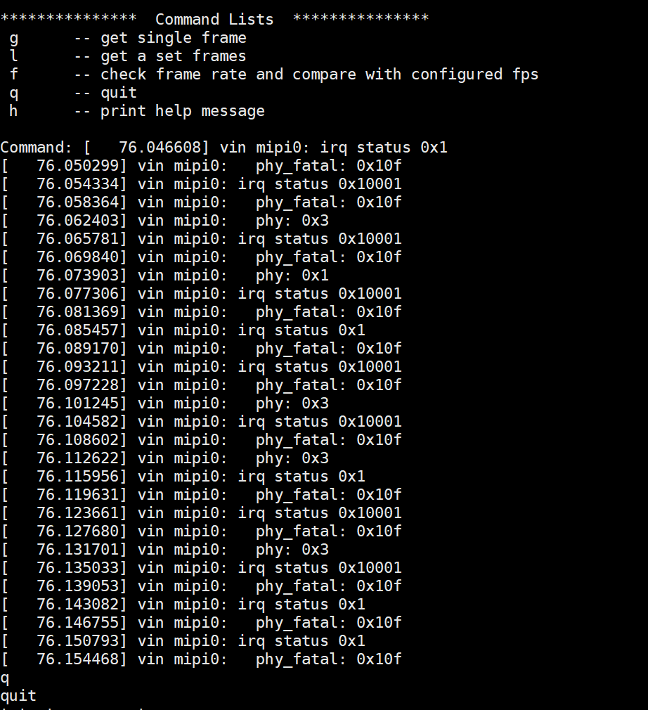

x5 平台点亮sensor,mipi报错
通过gsml传输sensor数据,sensor分辨率1080x2560, 4lane,yuv422 8bit格式,目前跑get_vin_data的demo,一直报mipi相关的错误
目前,sensor的mipi配置如下:static mipi_config_t mipi_config = {
.rx_enable = 1,
.rx_attr = {
    .phy = 0,
    .lane = 4,
    .datatype = 0x1E,
    .fps = SENSOE_FPS,
    //.mclk = 24,
    .mipiclk = 756,
    .width = SENSOR_WIDTH,
    .height = SENSOR_HEIGHT,
    .linelenth = 4536,
    .framelenth = 2778,//1500,
    .settle = 30,//20,
    .channel_num = 1,
    .channel_sel = {0},
