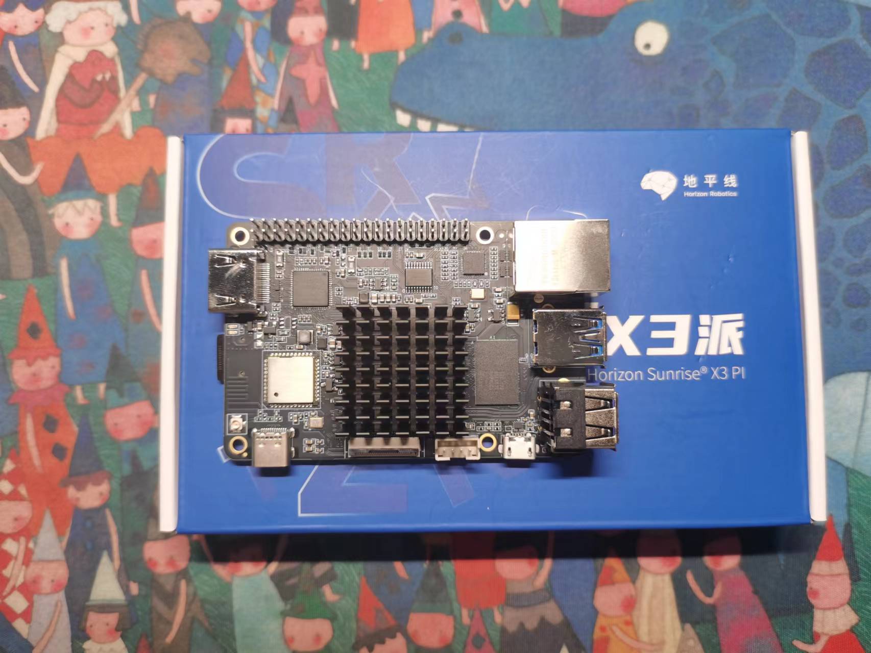

首先,非常感谢地平线官方给予这次旭日X3派开发板的测评机会,旭日X3派不同于其他派,全黑的外观倍感神秘,像一个深邃的黑洞,让人忍不住去探索!板载资源上不仅诚意满满,更是细节满满,处处为用户体验考虑,例如标准的HDMI接口,不需要使用转接头可以直接连接显示器等等。

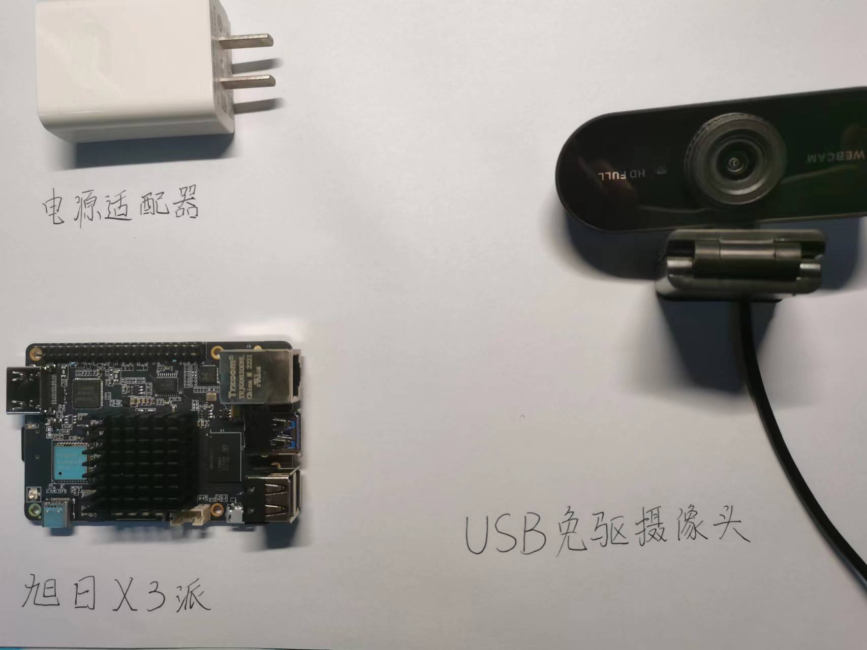

硬件部分:旭日X3派,USB免驱摄像头,电源适配器,烧录Ubuntu系统的SD卡,USB扬声器,显示屏(或者VNC/SSH远程连接)

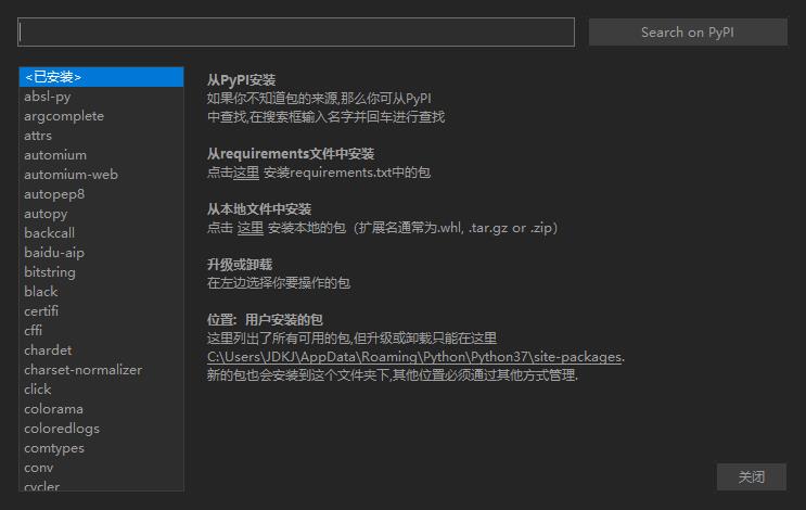

启动Thonny IDE后,选择左上方工具>>管理包,然后根据附件中提供的程序开始安装python依赖库
过程可能会比较漫长,取决于当前网络情况,还有部分库文件可能会出现下载失败的情况,请耐心多尝试几次,不要放弃呀,胜利就在眼前啦!

这里有一个小坑大家要注意一下哦,cv2是opencv-python的缩写,在import的时候采用这种缩写,但添加库的时候不能直接搜索cv2,而是要打全称opencv-python哦!!!

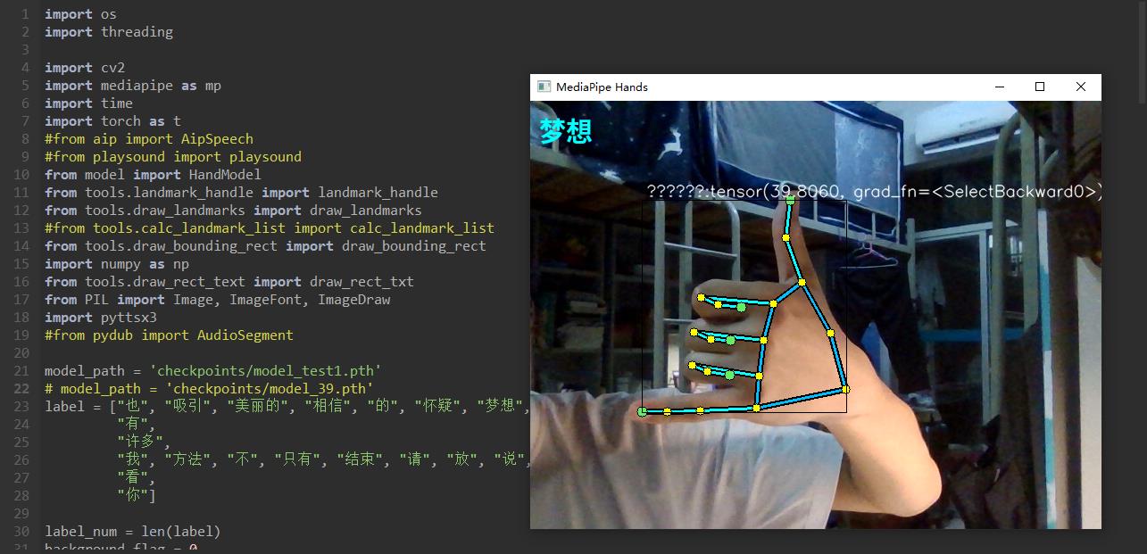

智能手语识别系统共包括语音播报模块,模型训练模块,手势识别模块,文字转写模块,一共可识别播报"也", "吸引", "美丽的", "相信", "的", "怀疑", "梦想", "表达", "眼睛", "给", "很难","有","许多","我", "方法", "不", "只有", "超过", "请", "放", "说", "微笑", "星星",  "十分", "看","你"等27个国家通用手语。
model_path = 'checkpoints/model_test1.pth'
label = ["也", "吸引", "美丽的", "相信", "的", "怀疑", "梦想", "表达", "眼睛", "给", "很难","有","许多","我", "方法", "不", "只有", "结束", "请", "放", "说", "微信", "星星", "十分","看","你"]

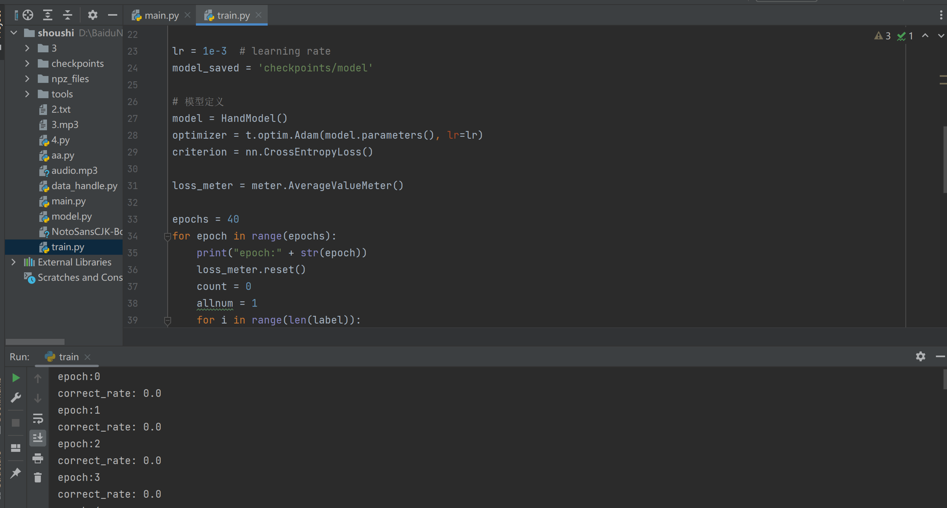

模型训练模块采用torch第三方库,torch广泛运用深度学习。它能够帮助我们构建深度学习项目,强调灵活性,而且允许使用我们习惯的python表示方法来表达深度学习模型。算力高,易学习,比较容易入门。
# 模型保存地址
targetX = [0 for xx in range(label_num)]
target = []
for xx in range(label_num):
    target_this = copy.deepcopy(targetX)
    target_this[xx] = 1
    target.append(target_this)
# 独热码
lr = 1e-3  # learning rate
model_saved = 'checkpoints/model'
# 模型定义
model = HandModel()
optimizer = t.optim.Adam(model.parameters(), lr=lr)
criterion = nn.CrossEntropyLoss()
loss_meter = meter.AverageValueMeter()
epochs = 40
for epoch in range(epochs):
    print("epoch:" + str(epoch))
    loss_meter.reset()
    count = 0
    allnum = 1
    for i in range(len(label)):
        data = np.load('./npz_files/' + label[i] + ".npz", allow_pickle=True)
        data = data['data']
        for j in range(len(data)):
            xdata = t.tensor(data[j])
            optimizer.zero_grad()
            this_target = t.tensor(target[i]).float()
            input_, this_target = Variable(xdata), Variable(this_target)
            output = model(input_)
            outLabel = label[output.tolist().index(max(output))]
            targetIndex = target[i].index(1)
            targetLabel = label[targetIndex]
            if targetLabel == outLabel:
                count += 1
            allnum += 1
            output = t.unsqueeze(output, 0)
            this_target = t.unsqueeze(this_target, 0)
            loss = criterion(output, this_target)
            loss.backward()
            optimizer.step()
            loss_meter.add(loss.data)
    print("correct_rate:", str(count / allnum))
    t.save(model.state_dict(), '%s_%s.pth' % (model_saved, epoch))
然后准备好数据集就可以开始愉快地训练模型啦,模型推荐在电脑上进行训练,然后我自己的电脑是win10的系统,用的pycharm IDE的集成开发环境,如果只是想体验一下的话也可以直接使用附件里训练好的模型哦。

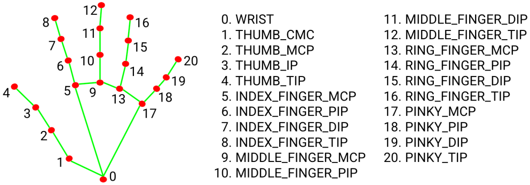

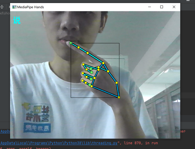

手势识别模块采用Mediapiap和Opencv库对人手进行特征提取与骨骼绑定,旭日X3派根据摄像头捕捉的关键帧的进行特征提取,基于PyTroch模型进行推理,并将推理翻译结果显示到屏幕上,同时将翻译结果以txt文件形式进行保存和API接入后上传到百度语音开发平台,由平台进行人声的合成,然后将生成的mp3文件下载到旭日X3派终端用扬声器进行播放,实现了为语言障碍人士发声,为碍发声,更是为爱发声。

#骨架绑定的可视化
draw_landmarks(frame, hand_local)
brect = draw_bounding_rect(frame, hand_local)

得益于旭日X3派的强大算力,系统对手势的识别展示并播报十分灵敏,画面流程度也得到保障,不过温馨提示,长时间运行请准备小风扇给开发板降温哦。

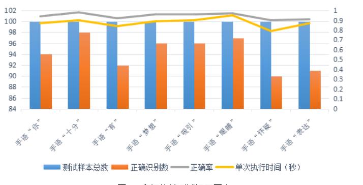

四、系统性能测试
系统测试方案:将训练好模型导入旭日X3派中,接入电源后等待初始化完成,由我亲爱的小组成员们随机在镜头前做出27个国家通用手语,将翻译终端识别播报的准确率记录,同时将识别的总时长记录收集。
测试数据如下:
结果分析:实验数据表明,27个国家通用手语随机检验的识别准确率均在90%以上,单次执行时间也均在1秒之内。
结论:手语翻译终端有很高的实时性,充分保障聋哑残障人士的无障碍沟通交流。
