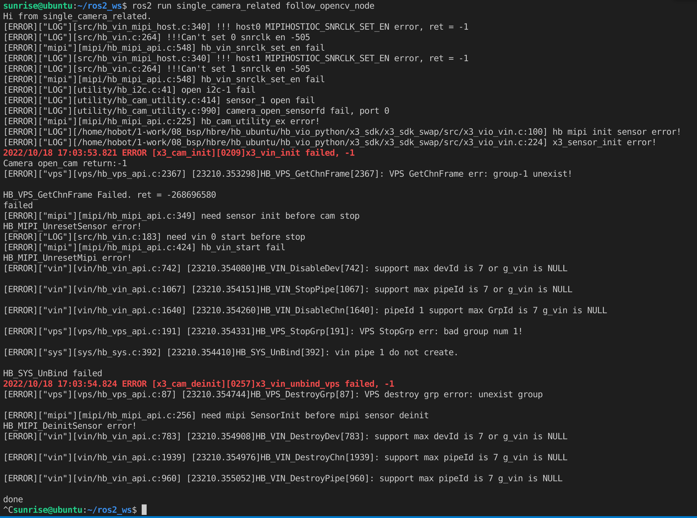

调用open_cam接口遇到问题
代码:
import sys, os, time
sys.path.append('/usr/lib/hobot-srcampy')
import rclpy
from rclpy.node import Node
from hobot_vio import libsrcampy
import numpy as np
import cv2
class Vision_decision(Node):
    def __init__(self, name):
        super().__init__(name)
        self.test_camera()
    def test_camera(self):
        cam = libsrcampy.Camera()
        ret = cam.open_cam(1, 1, 30, 1920, 1080)
        print("Camera open_cam return:%d" % ret)
        time.sleep(1)
        img = cam.get_img(2)
        if img is not None:
            fo = open("output.img", "wb")
            fo.write(img)
            fo.close()
            print("success")
        else:
            print("failed")
        cam.close_cam()
        print("done")
def main(args=None):
    print('Hi from single_camera_related.')
    rclpy.init()
    node = Vision_decision("follow_opencv_node")
    try:
        rclpy.spin(node)
    except KeyboardInterrupt:
        pass
    finally:
        node.destroy_node()
        rclpy.shutdown()
if __name__ == '__main__':
    main()
报错信息:
f37摄像头可以看到-

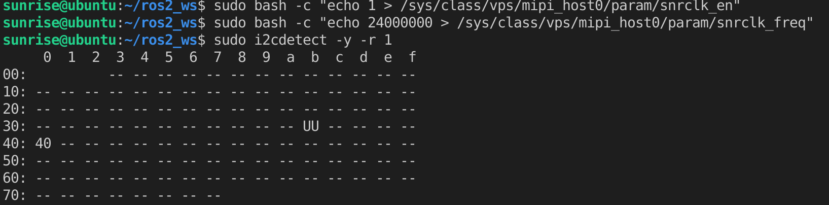

你好
你链接的硬件口是对的吗,看着mipi跟i2c都没通呢
您好,需要在root权限下运行,sunrise没有接口的权限?
