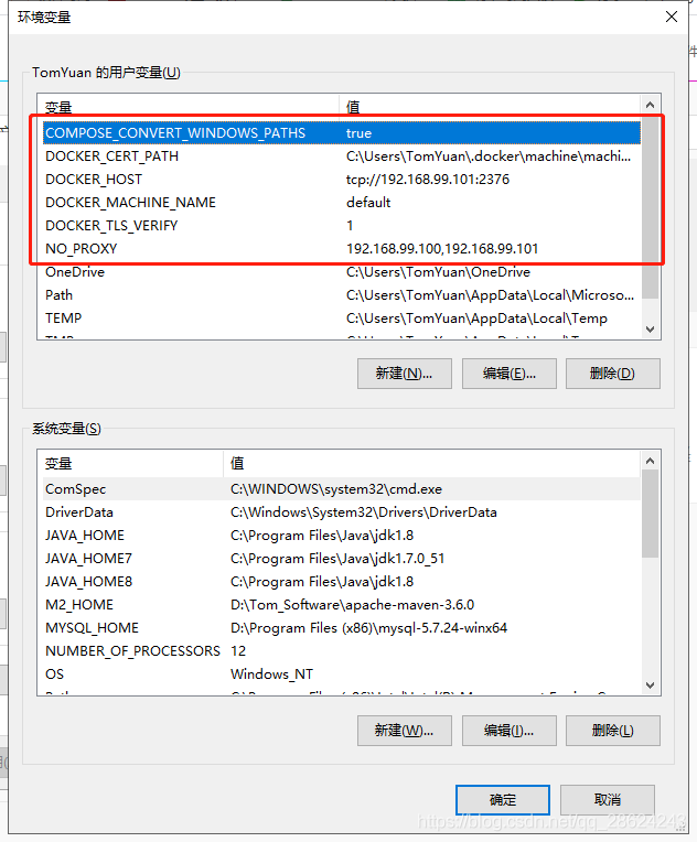

安装完成后,如果曾经安装过docker toolbox软件,在cmd中输入docker时会出现如下报错-
error during connect: Post "https://192.168.99.100:2376/v1.24/images/load?quiet=0": dial tcp 192.168.99.100:2376: connectex: A connection attempt failed because the connected party did not properly respond after a period of time, or established connection failed because connected host has failed to respond.-
此外,打开docker desktop软件会一直卡在starting the docker engineer的画面(由于未截屏,问题已解决,缺乏照片)-
需要首先将docker toolbox卸载,并且将下图框中的几个环境变量删除
我就是因为安装过docker toolbox所以导致多次镜像安装不成功,并且打开docker desktop时卡在开始界面-
