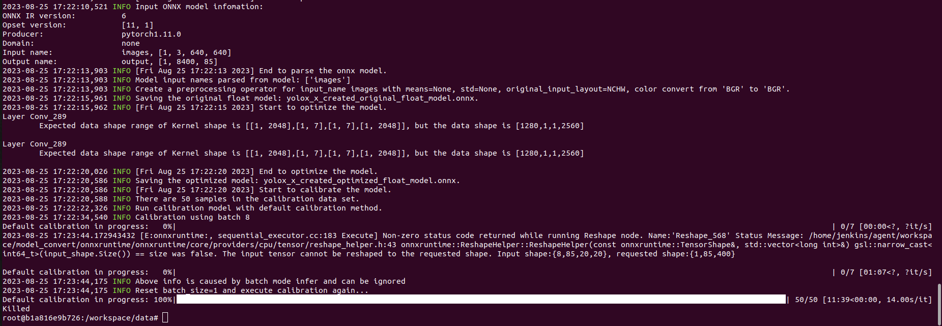

  2. 问题具体描述:目的是在docker中将yolox.onnx文件转换为.bin文件;在运行“hb_mapper makertbin”时出现以下错误:
问题截图部分
以下是模型转换的详细过程:
附件链接:
运行docker容器进行模型转换

    Layer Conv_289
    Expected data shape range of Kernel shape is [[1, 2048],[1, 7],[1, 7],[1, 2048]], but the data shape is [1280,1,1,2560]
    Layer Conv_289

模型转换
hb_mapper makertbin --config ./yolox_x_config.yaml --model-type onnx
  • 输出结果(等了好长时间~):
    2023-08-25 17:22:09,222 INFO log will be stored in /workspace/data/hb_mapper_makertbin.log
    2023-08-25 17:22:09,223 INFO Start hb_mapper…
    2023-08-25 17:22:09,223 INFO hbdk version 3.45.3
    2023-08-25 17:22:09,223 INFO horizon_nn version 0.18.2
    2023-08-25 17:22:09,223 INFO hb_mapper version 1.17.4
    2023-08-25 17:22:09,223 INFO Start Model Convert…
    2023-08-25 17:22:09,234 INFO Using onnx model file: /workspace/data/yolox_x_created.onnx
    2023-08-25 17:22:09,740 INFO Model has 1 inputs according to model file
    2023-08-25 17:22:09,740 INFO Model name not given in yaml_file, using model name from model file: [‘images’]
    2023-08-25 17:22:09,740 INFO Model input shape not given in yaml_file, using shape from model file: [[1, 3, 640, 640]]
    2023-08-25 17:22:09,741 INFO The calibration dir name suffix is the same as the value float32 of the cal_data_type parameter and will be read with the value of cal_data_type.
    2023-08-25 17:22:09,741 INFO custom_op does not exist, skipped
    2023-08-25 17:22:09,741 WARNING Input node images’s input_source not set, it will be set to ddr by default
    2023-08-25 17:22:09,745 INFO *******************************************
    2023-08-25 17:22:09,745 INFO First calibration picture name: 000000006818.bgr
    2023-08-25 17:22:09,745 INFO First calibration picture md5:
    535830d27d3f863110d153c9f0eebf1c /workspace/data/calibration_data_bgr_f32/000000006818.bgr
    2023-08-25 17:22:09,758 INFO *******************************************
    2023-08-25 17:22:10,073 INFO [Fri Aug 25 17:22:10 2023] Start to Horizon NN Model Convert.
    2023-08-25 17:22:10,073 INFO Loading horizon_nn debug methods:
    2023-08-25 17:22:10,073 INFO Parsing the input parameter:{‘images’: {‘input_shape’: [1, 3, 640, 640], ‘input_batch’: 1, ‘expected_input_type’: ‘BGR_128’, ‘original_input_type’: ‘BGR’, ‘original_input_layout’: ‘NCHW’}}
    2023-08-25 17:22:10,074 INFO Parsing the calibration parameter
    2023-08-25 17:22:10,074 INFO Parsing the hbdk parameter:{‘hbdk_pass_through_params’: '–O3 --core-num 2 --fast ', ‘input-source’: {‘images’: ‘ddr’, ‘_default_value’: ‘ddr’}}
    2023-08-25 17:22:10,074 INFO HorizonNN version: 0.18.2
    2023-08-25 17:22:10,074 INFO HBDK version: 3.45.3
    2023-08-25 17:22:10,074 INFO [Fri Aug 25 17:22:10 2023] Start to parse the onnx model.
    2023-08-25 17:22:10,521 INFO Input ONNX model infomation:
    ONNX IR version: 6
    Opset version: [11, 1]
    Producer: pytorch1.11.0
    Domain: none
    Input name: images, [1, 3, 640, 640]
    Output name: output, [1, 8400, 85]
    2023-08-25 17:22:13,903 INFO [Fri Aug 25 17:22:13 2023] End to parse the onnx model.
    2023-08-25 17:22:13,903 INFO Model input names parsed from model: [‘images’]
    2023-08-25 17:22:13,903 INFO Create a preprocessing operator for input_name images with means=None, std=None, original_input_layout=NCHW, color convert from ‘BGR’ to ‘BGR’.
    2023-08-25 17:22:15,961 INFO Saving the original float model: yolox_x_created_original_float_model.onnx.
    2023-08-25 17:22:15,962 INFO [Fri Aug 25 17:22:15 2023] Start to optimize the model.
    Layer Conv_289
    Layer Conv_289
    2023-08-25 17:22:20,026 INFO [Fri Aug 25 17:22:20 2023] End to optimize the model.
    2023-08-25 17:22:20,586 INFO Saving the optimized model: yolox_x_created_optimized_float_model.onnx.
    2023-08-25 17:22:20,586 INFO [Fri Aug 25 17:22:20 2023] Start to calibrate the model.
    2023-08-25 17:22:20,588 INFO There are 50 samples in the calibration data set.
    2023-08-25 17:22:22,326 INFO Run calibration model with default calibration method.
    2023-08-25 17:22:34,540 INFO Calibration using batch 8
    Default calibration in progress: 0%| | 0/7 [00:00<?, ?it/s]2023-08-25 17:23:44.172943432 [E:onnxruntime:, sequential_executor.cc:183 Execute] Non-zero status code returned while running Reshape node. Name:‘Reshape_568’ Status Message: /home/jenkins/agent/workspace/model_convert/onnxruntime/onnxruntime/core/providers/cpu/tensor/reshape_helper.h:43 onnxruntime::ReshapeHelper::ReshapeHelper(const onnxruntime::TensorShape&, std::vector&) gsl::narrow_cast<int64_t>(input_shape.Size()) == size was false. The input tensor cannot be reshaped to the requested shape. Input shape:{8,85,20,20}, requested shape:{1,85,400}
    Default calibration in progress: 0%| | 0/7 [01:07<?, ?it/s]
    2023-08-25 17:23:44,175 INFO Above info is caused by batch mode infer and can be ignored
    2023-08-25 17:23:44,175 INFO Reset batch_size=1 and execute calibration again…
    Default calibration in progress: 100%|█████████████████████████████████████████████████████████████████████████████████████████████████████████████████████████████████████| 50/50 [11:39<00:00, 14.00s/it]
    Killed

    2023-08-25 17:22:10,073 file: build.py func: build line No: 35 [Fri Aug 25 17:22:10 2023] Start to Horizon NN Model Convert.
    2023-08-25 17:22:10,073 file: model_debug.py func: model_debug line No: 61 Loading horizon_nn debug methods:
    2023-08-25 17:22:10,073 file: dict_parser.py func: dict_parser line No: 33 Parsing the input parameter:{‘images’: {‘input_shape’: [1, 3, 640, 640], ‘input_batch’: 1, ‘expected_input_type’: ‘BGR_128’, ‘original_input_type’: ‘BGR’, ‘original_input_layout’: ‘NCHW’}}
    2023-08-25 17:22:10,074 file: build.py func: build line No: 186 Parsing the calibration parameter
    2023-08-25 17:22:10,074 file: dict_parser.py func: dict_parser line No: 440 Parsing the hbdk parameter:{‘hbdk_pass_through_params’: '–O3 --core-num 2 --fast ', ‘input-source’: {‘images’: ‘ddr’, ‘_default_value’: ‘ddr’}}
    2023-08-25 17:22:10,074 file: build.py func: build line No: 150 HorizonNN version: 0.18.2
    2023-08-25 17:22:10,074 file: build.py func: build line No: 154 HBDK version: 3.45.3
    2023-08-25 17:22:10,074 file: build.py func: build line No: 35 [Fri Aug 25 17:22:10 2023] Start to parse the onnx model.
    2023-08-25 17:22:10,521 file: onnx_parser.py func: onnx_parser line No: 241 Input ONNX model infomation:
    ONNX IR version: 6
    Domain: none
    2023-08-25 17:22:13,903 file: build.py func: build line No: 38 [Fri Aug 25 17:22:13 2023] End to parse the onnx model.
    2023-08-25 17:22:13,903 file: build.py func: build line No: 217 Model input names parsed from model: [‘images’]
    2023-08-25 17:22:13,903 file: dict_parser.py func: dict_parser line No: 247 Create a preprocessing operator for input_name images with means=None, std=None, original_input_layout=NCHW, color convert from ‘BGR’ to ‘BGR’.
    2023-08-25 17:22:15,961 file: build.py func: build line No: 464 Saving the original float model: yolox_x_created_original_float_model.onnx.
    2023-08-25 17:22:15,962 file: build.py func: build line No: 35 [Fri Aug 25 17:22:15 2023] Start to optimize the model.
    2023-08-25 17:22:20,026 file: build.py func: build line No: 38 [Fri Aug 25 17:22:20 2023] End to optimize the model.
    2023-08-25 17:22:20,586 file: build.py func: build line No: 487 Saving the optimized model: yolox_x_created_optimized_float_model.onnx.
    2023-08-25 17:22:20,586 file: build.py func: build line No: 35 [Fri Aug 25 17:22:20 2023] Start to calibrate the model.
    2023-08-25 17:22:20,588 file: calibration_data_set.py func: calibration_data_set line No: 89 input name: images, number_of_samples: 50
    2023-08-25 17:22:20,588 file: calibration_data_set.py func: calibration_data_set line No: 100 There are 50 samples in the calibration data set.
    2023-08-25 17:22:22,326 file: default_calibrater.py func: default_calibrater line No: 145 Run calibration model with default calibration method.
    2023-08-25 17:22:34,540 file: calibrater.py func: calibrater line No: 194 Calibration using batch 8
    2023-08-25 17:23:44,174 file: calibrater.py func: calibrater line No: 217 [ONNXRuntimeError] : 6 : RUNTIME_EXCEPTION : Non-zero status code returned while running Reshape node. Name:‘Reshape_568’ Status Message: /home/jenkins/agent/workspace/model_convert/onnxruntime/onnxruntime/core/providers/cpu/tensor/reshape_helper.h:43 onnxruntime::ReshapeHelper::ReshapeHelper(const onnxruntime::TensorShape&, std::vector&) gsl::narrow_cast<int64_t>(input_shape.Size()) == size was false. The input tensor cannot be reshaped to the requested shape. Input shape:{8,85,20,20}, requested shape:{1,85,400}
    2023-08-25 17:23:44,175 file: calibrater.py func: calibrater line No: 218 Above info is caused by batch mode infer and can be ignored
    2023-08-25 17:23:44,175 file: calibrater.py func: calibrater line No: 220 Reset batch_size=1 and execute calibration again…
你好,请问你转YOLOX得bin模型时,使用的工具链是地平线官方提供的OE开发包吗?有自己做别的修改吗?你分享的百度云链接失效了,可以在分享一下吗?麻烦你了!
问卷链接:地平线算法工具链使用满意度反馈
你好,这个模型有使用onnxruntime==1.2.0进行过推理吗,如果没有建议先试一下,如果推理过程中有报错,需要先检查模型的合法性
之前推理的时候一直用的是1.15.1版本(onnxruntime-gpu 1.15.1 pypi_0 pypi),用onnxruntime推理过程中是没问题的。而且运行hb_mapper checker时,也没有报错的。必须是1.2.0版本的onnxruntime吗?
onnxruntime==1.2.0 也是可以推理的
你好,使用您提供的模型和校准数据,我这边没有复现图片中的问题,可以正常转换编译。这边建议您再次尝试,大概率是因为资源占用过大而导致进程被kill
好的,谢谢~ 明天试一下
这次重启电脑之后只运行这一个程序,成功了。谢谢~
确实是资源占用过大的原因,16GB的内存勉强够用。
