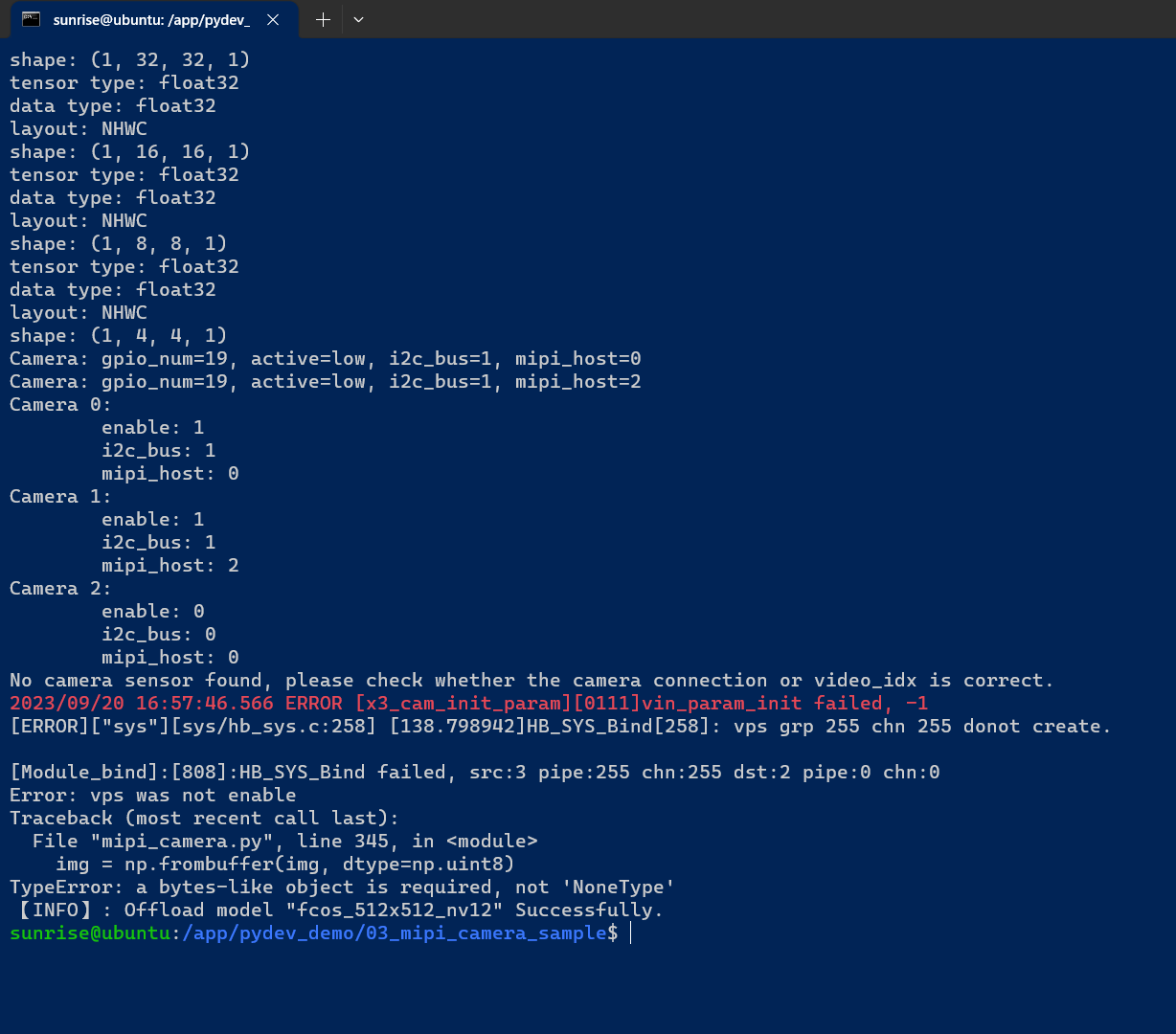

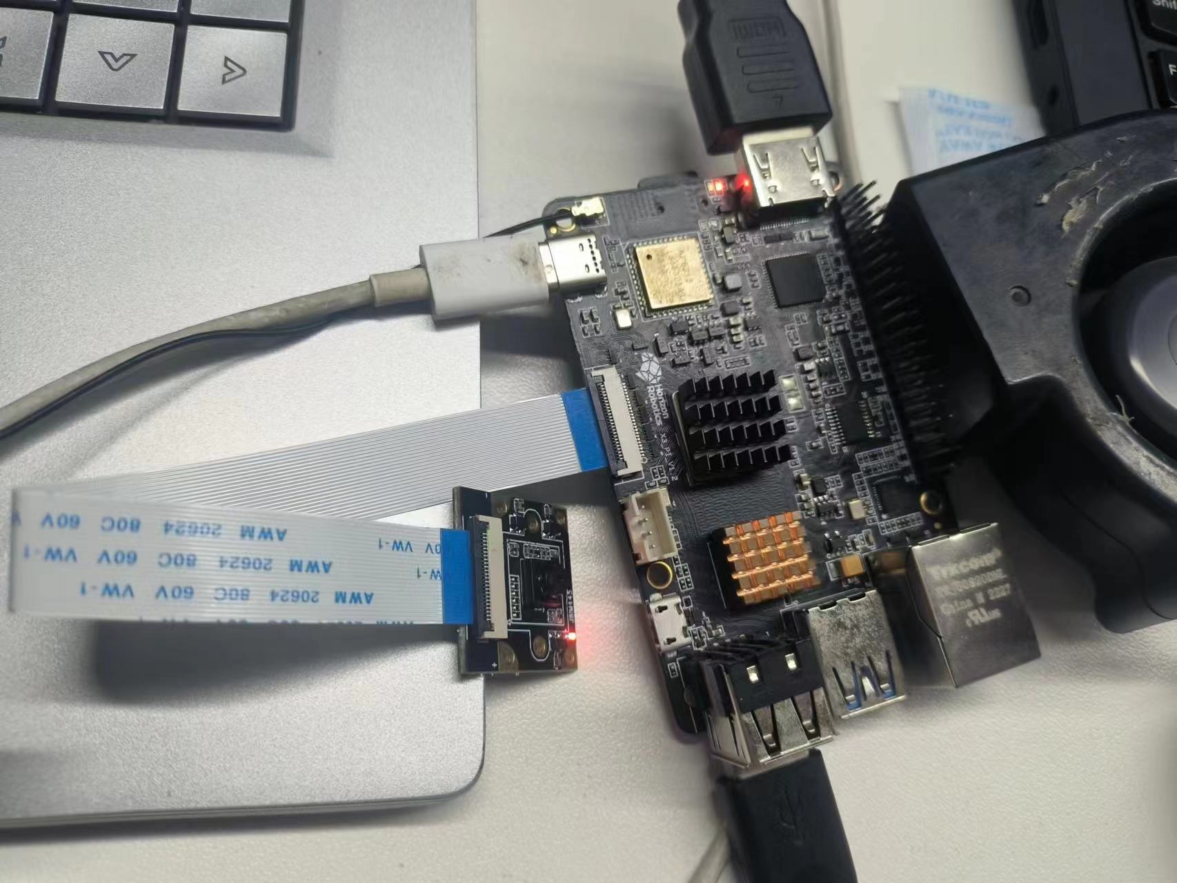

mipi摄像头官方示例,运行官方示例时报错,mipi摄像头初始化失败,不清楚是不是mipi摄像头坏了
cd /app/pydev_demo/03_mipi_camera_samplesudo python3 mipi_camera.py

我之前7月17日下的镜像,我们做了imx327的驱动,将libhbspdev.so 拷贝到开发板的/usr/lib/下,将libimxf327.so 和libimx327_linear.so 拷贝到开发板的/usr/lib/sensorlib/下。摄像头正常工作。
我是9月20日下的镜像,将libhbspdev.so 拷贝到开发板的/usr/lib/下,将libimxf327.so 和libimx327_linear.so 拷贝到开发板的/usr/lib/sensorlib/下。摄像头不正常工作了,
报错如下:
sunrise@ubuntu:/app/pydev_demo/03_mipi_camera_sample$ sudo python3 mipi_camera.py
File “mipi_camera.py”, line 13, in
from hobot_vio import libsrcampy as srcampy
ImportError: /usr/local/lib/python3.8/dist-packages/hobot_vio/libsrcampy.so: undefined symbol: _ZN8srpy_cam9VPPCamera10OpenCameraEiiiiP21x3_sensors_parametersPiS3_
