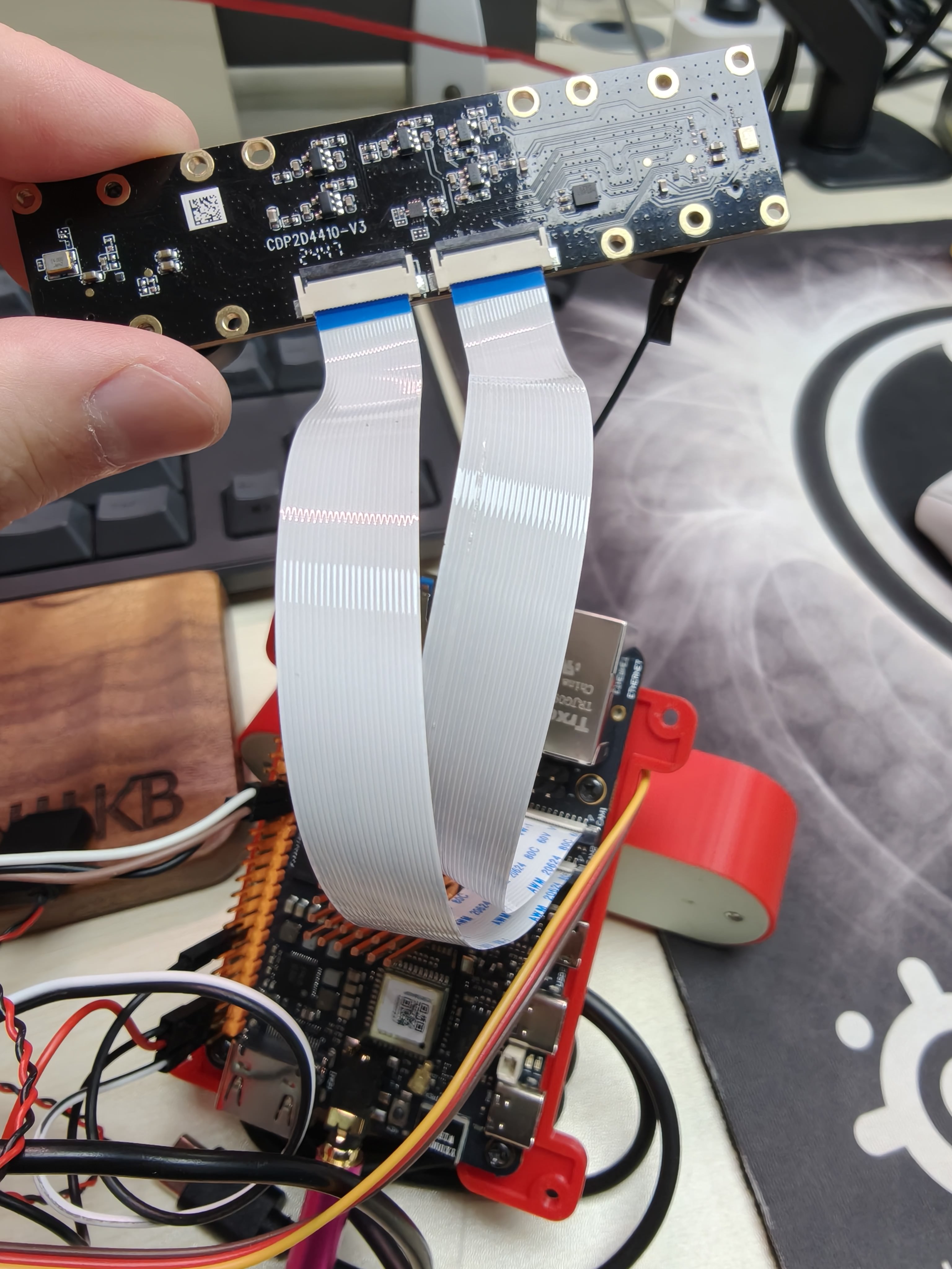

[图像算法][RDK X5][MIPI Camera报错]
尝试运行ROS2双目示例代码错误
root@ubuntu:/app/pydev_demo/03_mipi_camera_sample# ros2 launch hobot_stereonet stereonet_model_web_visual_v2.launch.py \
need_rectify:=False mipi_image_width:=640 mipi_image_height:=352 \
height_min:=-10.0 height_max:=10.0 pc_max_depth:=5.0 \
save_image_all:=True save_freq:=4 save_dir:=./stereonet_result save_total:=10

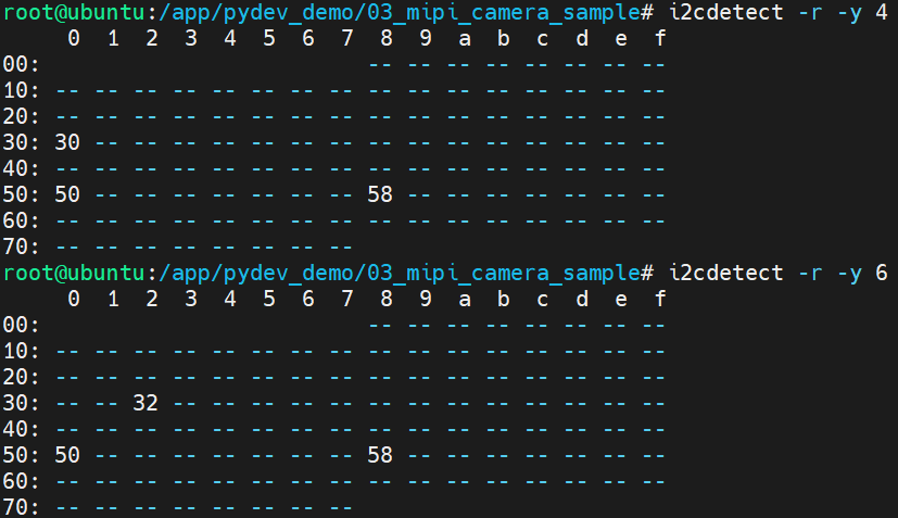

[mipi_cam-1] Wrong coordinate (1004.655518, -0.242919) (1007.623108, -0.227773) (1004.683228, 1.854633) (1007.655762, 1.869821), must bigger than 0
[mipi_cam-1] [ERROR] [1744282402.126031004] [mipi_cap]: hbn_gen_gdc_bin failed, ret = 0
[mipi_cam-1]
[mipi_cam-1] [WARN] [1744282402.138666162] [mipi_cap]: gdc bin file ������ open failed
[mipi_cam-1]
[mipi_cam-1] [WARN] [1744282403.331056908] [mipi_cap]: gdc bin file ������ open failed
[mipi_cam-1]
[mipi_cam-1] [WARN] [1744282404.354152304] [mipi_cam]: [init]->cap default init success.
[mipi_cam-1]
[mipi_cam-1] [WARN] [1744282404.354376219] [mipi_cam]: cal_file:/opt/tros/humble/lib/mipi_cam/config/calib_params.yaml
[mipi_cam-1] 无法打开标定参数文件!
[mipi_cam-1] [WARN] [1744282404.354512844] [mipi_node]: get camera calibration parameters failed
[mipi_cam-1] creat_camera_node cam_fd = 187650920287784
[mipi_cam-1] csi2 ignore mclk ex attr, because not config mclk.
[mipi_cam-1] lpwm_enable: 0
[mipi_cam-1] lpwm_index: 0, trigger_source: 0, trigger_mode: 0, period: 33332, offset: 10, duty_time: 100, threshold: 0, adjust_step: 0
[mipi_cam-1] lpwm_index: 1, trigger_source: 0, trigger_mode: 0, period: 33332, offset: 10, duty_time: 100, threshold: 0, adjust_step: 0
[mipi_cam-1] lpwm_index: 2, trigger_source: 0, trigger_mode: 0, period: 33332, offset: 10, duty_time: 100, threshold: 0, adjust_step: 0
[mipi_cam-1] lpwm_index: 3, trigger_source: 0, trigger_mode: 0, period: 33332, offset: 10, duty_time: 100, threshold: 0, adjust_step: 0
[mipi_cam-1] mipi mclk is not configed.
[mipi_cam-1] Searching camera sensor on device: /proc/device-tree/soc/cam/vcon@0 mclk_is_not_configed: 1
[mipi_cam-1] i2c bus: 6 mipi rx phy: 0
[mipi_cam-1] WARN: Sensor Name: sc230ai-30fps, Expected Chip ID: 0xCB34, Actual Chip ID Read: 0x00
[mipi_cam-1] INFO: vp_sensor_fixed_mipi_host_1 Found sensor_name:sc230ai-30fps on mipi rx csi 0, i2c addr 0x32, config_file:linear_1920x1080_raw10_30fps_1lane.c
[mipi_cam-1] creat_camera_node cam_fd = 187650920288264
[mipi_cam-1] csi0 ignore mclk ex attr, because not config mclk.
[mipi_cam-1] [ERROR] [1744282404.533266219] [mipi_node]: grab failed
[mipi_cam-1] [ERROR] [1744282404.533589176] [mipi_node]: grab failed
[mipi_cam-1] [ERROR] [1744282404.674873658] [mipi_node]: grab failed
[mipi_cam-1] [ERROR] [1744282404.675148615] [mipi_node]: grab failed
[mipi_cam-1] [ERROR] [1744282404.816545014] [mipi_node]: grab failed
[mipi_cam-1] [ERROR] [1744282404.816868346] [mipi_node]: grab failed
[mipi_cam-1] [ERROR] [1744282404.958219036] [mipi_node]: grab failed
[mipi_cam-1] [ERROR] [1744282404.958758034] [mipi_node]: grab failed
[mipi_cam-1] [ERROR] [1744282405.099707144] [mipi_node]: grab failed
[mipi_cam-1] [ERROR] [1744282405.100047184] [mipi_node]: grab failed
[mipi_cam-1] [ERROR] [1744282405.241350876] [mipi_node]: grab failed
[mipi_cam-1] [ERROR] [1744282405.241437751] [mipi_node]: grab failed
[mipi_cam-1] [ERROR] [1744282405.382899859] [mipi_node]: grab failed
[mipi_cam-1] [ERROR] [1744282405.382916026] [mipi_node]: grab failed
[mipi_cam-1] [ERROR] [1744282405.524600259] [mipi_node]: grab failed
[mipi_cam-1] [ERROR] [1744282405.524754258] [mipi_node]: grab failed

你好,您的系统镜像确实都是最新的了,同时miniboot也是最新的了。能否辛苦再补充一下您的双目相机外观照片,安装的照片和购买链接,我再帮您详细看看
【淘宝】限时淘金币抵7.4元 https://e.tb.cn/h.67OdWJpC3wOLDUz?tk=XfjFVbS4yXw CZ001 「官方地瓜机器人RDK X5 MIPI 双目相机模组 Stereo Camera Module」 点击链接直接打开 或者 淘宝搜索直接打开
也是完全按照教程安装的

是的,现在排查不出来原因,所以需要您补充安装的照片,我才好帮你转到内部研发去分析,否则内部的意见也是检查线路连接,这样解决不了你的问题。板子、摄像头、系统软件都是QA全量测过的,不会有问题。

还是一样的,会不会是接口或者摄像头板有问题?

观察一下这几个数值是否有变化,sif、isp、vse、gdc,如果存在没有变化的,说明可能摄像头板有问题
58 sif 一直是0
你好,我也是有一个sif一直是0,请问是摄像头板的问题吗?
