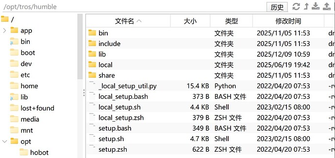

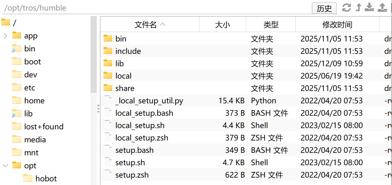

执行colcon build --packages-select dnn_node_sample,只有X3,没有X5,有影响吗?如果进行dnn_node_example编译修改呢,如何自定义呢?
root@ubuntu:/app/hobot_dnn/dnn_node_sample# colcon build --packages-select dnn_node_sample
[2.809s] WARNING:colcon.colcon_core.package_selection:Some selected packages are already built in one or more underlay workspaces:
‘dnn_node_sample’ is in: /opt/tros/humble
If a package in a merged underlay workspace is overridden and it installs headers, then all packages in the overlay must sort their include directories by workspace order. Failure to do so may result in build failures or undefined behavior at run time.
If the overridden package is used by another package in any underlay, then the overriding package in the overlay must be API and ABI compatible or undefined behavior at run time may occur.
If you understand the risks and want to override a package anyways, add the following to the command line:
–allow-overriding dnn_node_sample
This may be promoted to an error in a future release of colcon-override-check.
Starting >>> dnn_node_sample
[Processing: dnn_node_sample]
— stderr: dnn_node_sample
invalid platform, build platform X3 default
PREFIX_PATH is x3
SYS_ROOT is
hobot_cv_LIBRARIES is /opt/tros/humble/lib/libhobot_cv.so
update HOBOTCV_LIB_INSTALL_PATH as /opt/tros/humble/lib
HOBOTCV_LIB_INSTALL_PATH is /opt/tros/humble/lib

您好,不建议切换到老版本tros,修改我给出的后处理相关代码后编译即可
