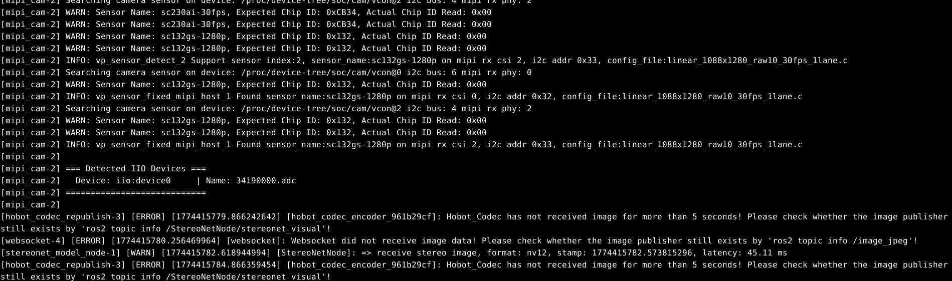

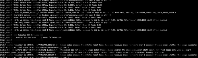

基于官方132GS MIPI双目相机运行双目Demo报错
升级到最新还是报一样的错

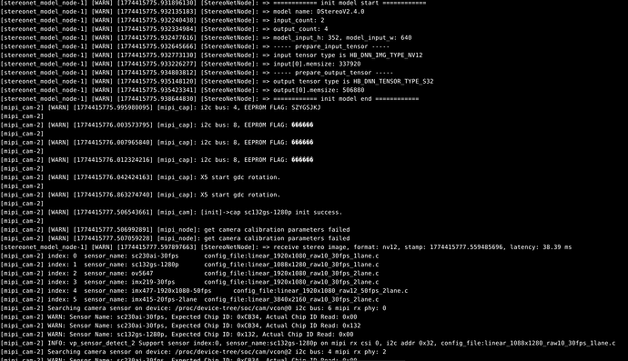

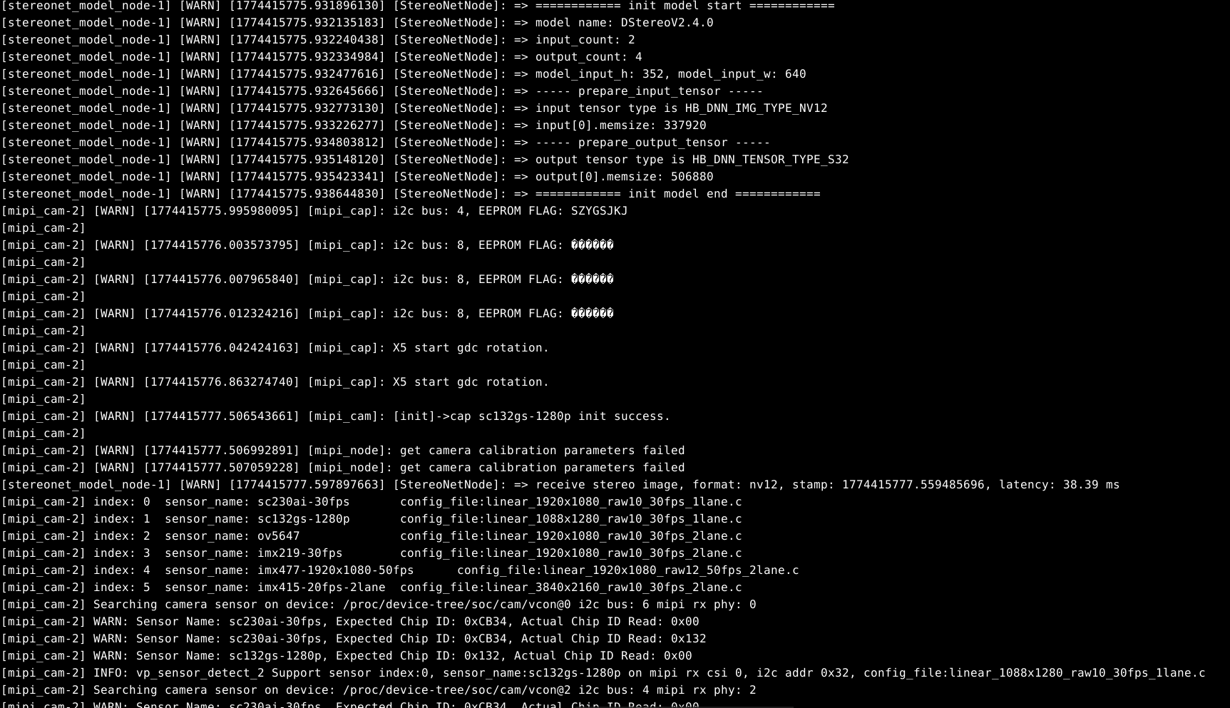

如何确认模组有没有标定文件,日志一致报获取标定文件失败
标定文件应该只是warning的报错,不会影响程序的使用,可以把完整的log附上,目前是没有看到节点启动失败的关键信息,内部测试正常使用
跑的是bash run_stereo.sh吗?看日志相机可以正确出流
是跑的bash run_stereo.sh,测试的过程中发现一个现象使用bash run_stereo.sh –camera_fx 600.0 –camera_fy 600.0 –camera_cx 640.0 –camera_cy 544.0 –baseline 0.10可以出深度,但是深度图是带畸变的,像没有做过GDC一样
可以测试一下再重启板卡后单独直接运行 bash run_stereo.sh 是否正常使用 ,还有就是用这个beta源把所有的相关包都更新一遍
参考https://forum.d-robotics.cc/t/topic/34406/4使用了离线标定文件,目测深度效果已正常

[hobot_codec_republish-3] [ERROR] [0946685943.406318970] [hobot_codec_encoder]: Hobot_Codec has not received image for more than 5 seconds! Please check whether the image publisher still exists by ‘ros2 topic info /StereoNetNode/stereonet_visual’!
[websocket-4] [ERROR] [0946685943.776129782] [websocket]: Websocket did not receive image data! Please check whether the image publisher still exists by ‘ros2 topic info /image_jpeg’!
[stereonet_model_node-1] [WARN] [0946685946.251049116] [StereoNetNode]: => receive stereo image, format: nv12, stamp: 946685946.217532160, latency: 33.50 ms
[hobot_codec_republish-3] [ERROR] [0946685948.406257675] [hobot_codec_encoder]: Hobot_Codec has not received image for more than 5 seconds! Please check whether the image publisher still exists by ‘ros2 topic info /StereoNetNode/stereonet_visual’!
[websocket-4] [ERROR] [0946685948.776218612] [websocket]: Websocket did not receive image data! Please check whether the image publisher still exists by ‘ros2 topic info /image_jpeg’!

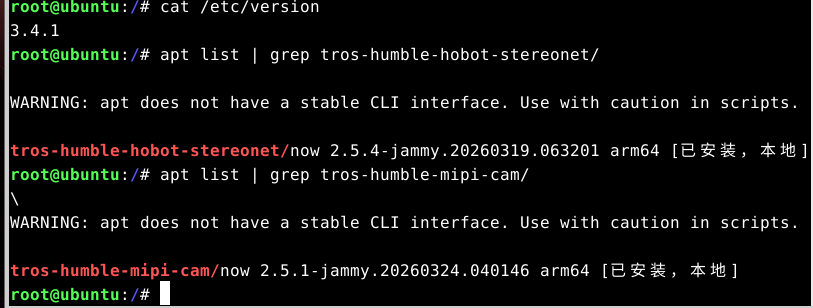

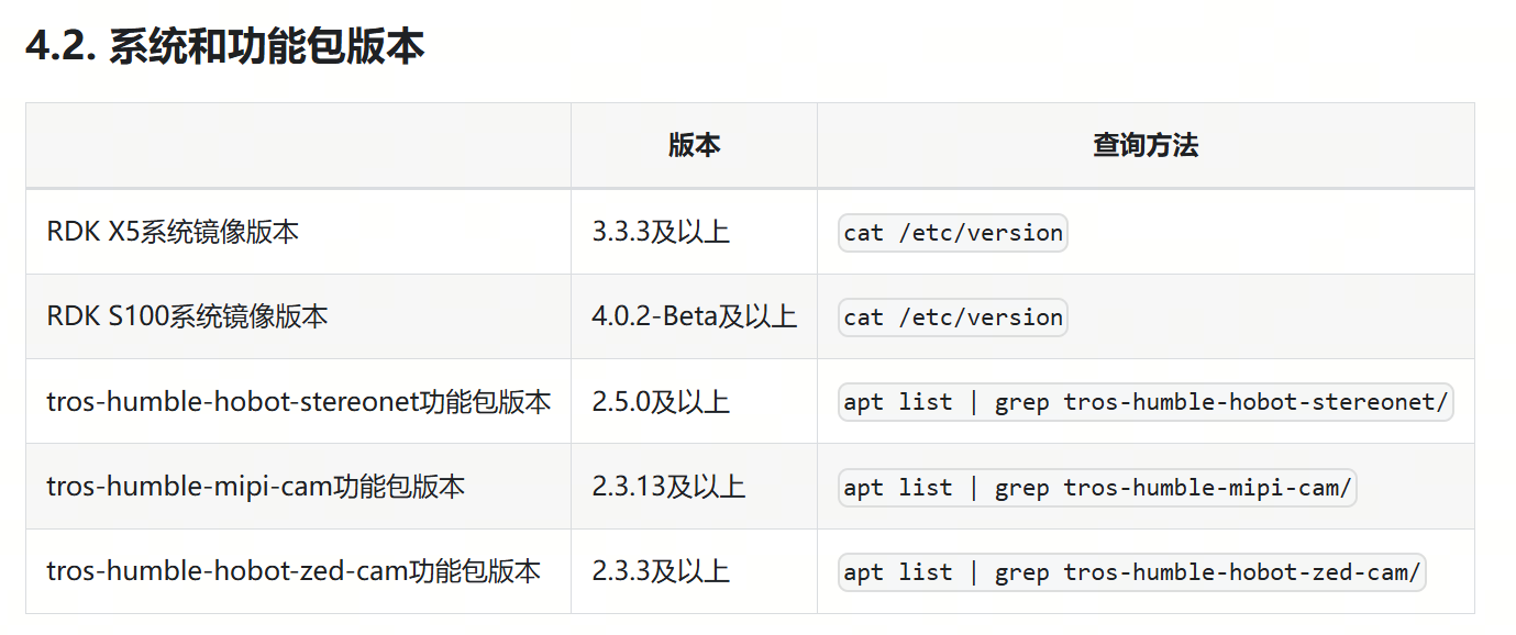

好的这边可以重新发帖 ,附上:
  1. 硬件连接方式,清晰图像信息
  2. 相关软件包信息,包括 系统镜像版本和以下信息:
  3. 具体的命令行操作步骤以及最终的日志打印信息
  4. ros2 topic list -v 列出的话题
等背景信息来具体分析
