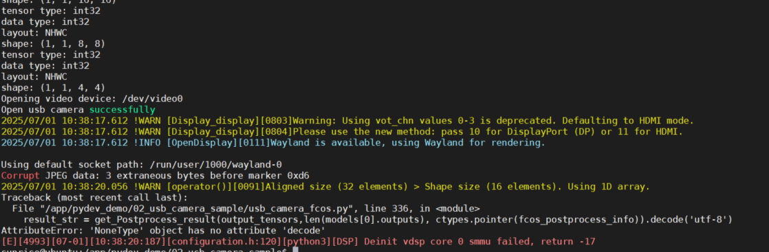

S100的板子,做demo用例里的usb摄像头,无法桌面显示目标画框,报错
连接的是logi的720P USB摄像头
可以使用usb_camera_snap.py拍照
无法使用usb_camera_fcos.py

Opening video device: /dev/video0
Open usb camera successfully
2025/07/01 10:38:17.612 !WARN [Display_display][0803]Warning: Using vot_chn values 0-3 is deprecated. Defaulting to HDMI mode.
2025/07/01 10:38:17.612 !WARN [Display_display][0804]Please use the new method: pass 10 for DisplayPort (DP) or 11 for HDMI.
2025/07/01 10:38:17.612 !INFO [OpenDisplay][0111]Wayland is available, using Wayland for rendering.
Using default socket path: /run/user/1000/wayland-0
Corrupt JPEG data: 3 extraneous bytes before marker 0xd6
2025/07/01 10:38:20.056 !WARN [operator()][0091]Aligned size (32 elements) > Shape size (16 elements). Using 1D array.
File “/app/pydev_demo/02_usb_camera_sample/usb_camera_fcos.py”, line 336, in
result_str = get_Postprocess_result(output_tensors,len(models[0].outputs), ctypes.pointer(fcos_postprocess_info)).decode(‘utf-8’)
AttributeError: ‘NoneType’ object has no attribute ‘decode’
[E][4993][07-01][10:38:20:187][configuration.h:120][python3][DSP] Deinit vdsp core 0 smmu failed, return -17

你好,S100这边bpu python接口在重构,如果需求只是Pyhton的/app/pydev_demo里面的案例可用,可以回退libucp的版本,可以参考: S100临时回退libucp版本 - 板卡使用 / 新手上路 - 地瓜机器人论坛
