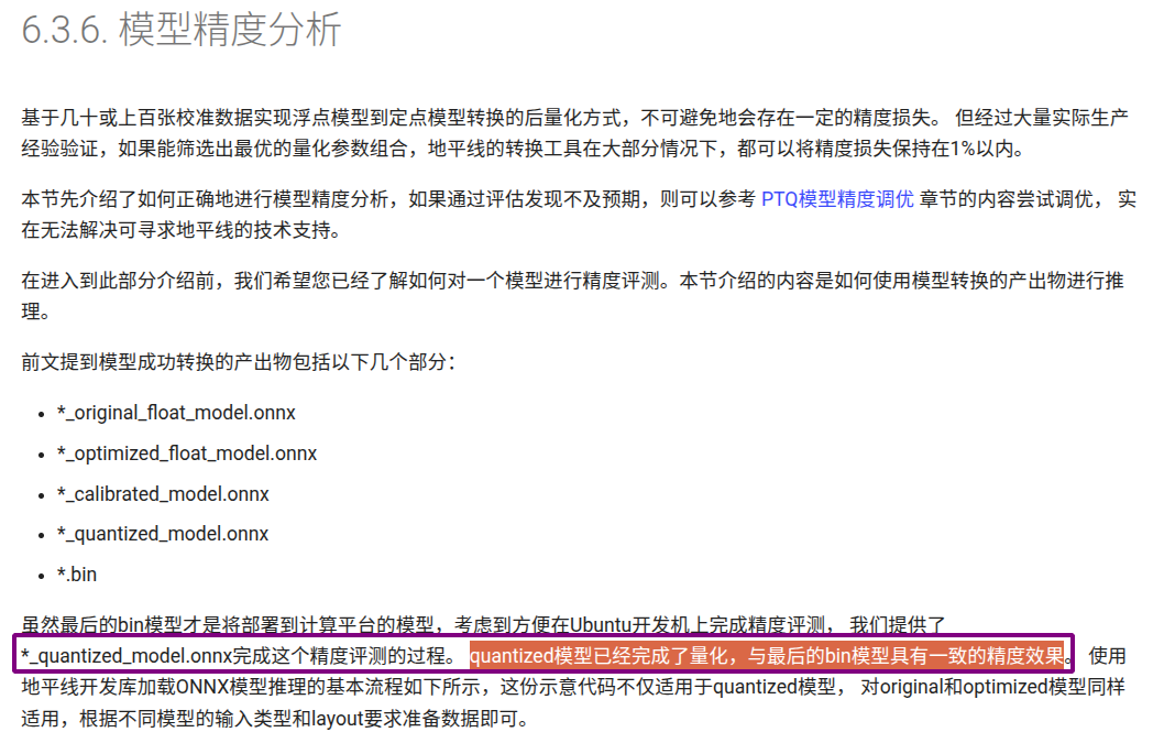

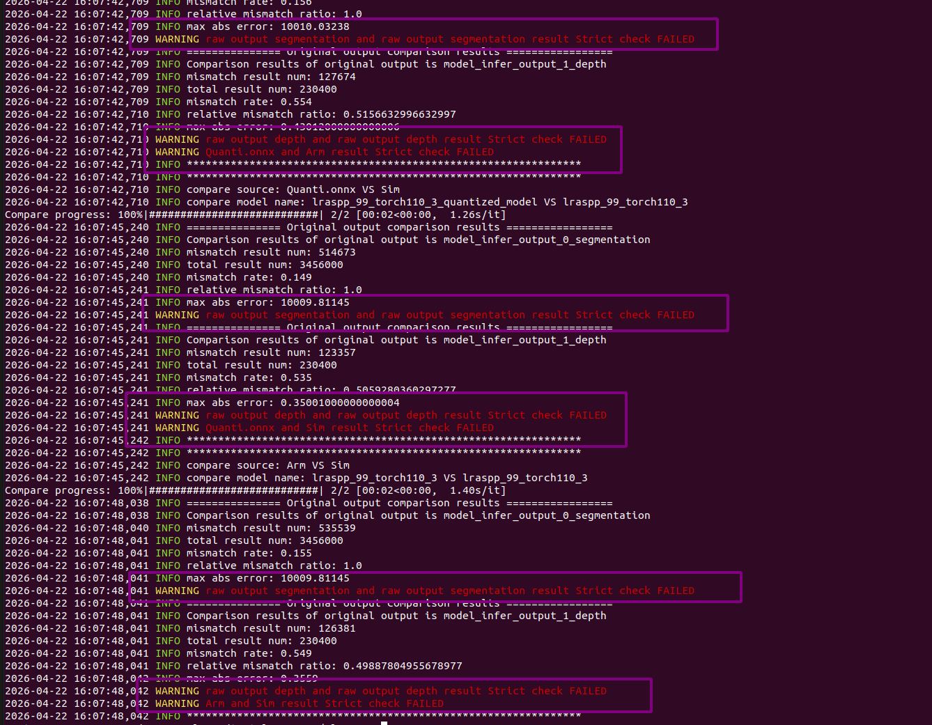

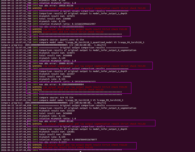

量化后.bin的模型与原始.onnx模型精度出现很大偏差,模型输出语义信息和深度信息。
问题现象:1. 深度信息模型输出:从原始模型.onnx ---------> *_quantized_model.onnx 量化模型基本无法偏差;从量化模型-------> 部署模型.bin 精度失真严重 2. 语义分割模型输出:从原始模型.onnx ---------> *_calibrated_model.onnx 标定模型出现偏差;已仔细校验过数据预处理部分,模型校验数据来自训练集经过预处理后的数据。
希望能提供指导意见,下步应该怎么去优化这个精度问题?

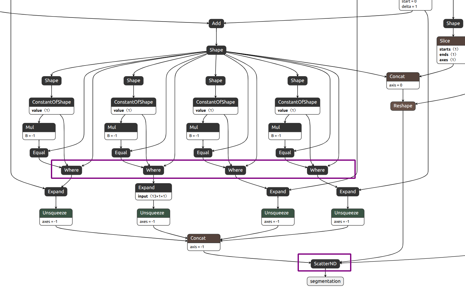

    "Resize_229": {'ON': 'CPU'},
    "Where_263_add": {'ON': 'CPU'},
    "Where_340_add": {'ON': 'CPU'},
    "ScatterND_337": {'ON': 'CPU'},
    "ScatterND_414": {'ON': 'CPU'},

Node                         ON   Subgraph  Type                           Cosine Similarity  Threshold  DataType
Conv_0                       BPU  id(0)     HzSQuantizedConv               0.998309           2.60514    int8
Mul_2                        BPU  id(0)     HzLut                          0.997139           10.1118    int8
Conv_3                       BPU  id(0)     HzSQuantizedConv               0.994793           8.38896    int8
Conv_5                       BPU  id(0)     HzSQuantizedConv               0.993418           10.6208    int8
Conv_7                       BPU  id(0)     HzSQuantizedConv               0.993278           13.4133    int8
Conv_9                       CPU  --        Conv                           0.989467           --         float
Relu_10                      CPU  --        Relu                           0.990015           --         float
Conv_11                      BPU  id(1)     HzSQuantizedConv               0.989846           7.45639    int8
Conv_12                      CPU  --        Conv                           0.987067           7.40217    float
Relu_13                      CPU  --        Relu                           0.988067           --         float
Conv_14                      CPU  --        Conv                           0.977649           --         float
Relu_15                      CPU  --        Relu                           0.979836           --         float
Conv_16                      CPU  --        Conv                           0.972007           --         float
Add_17                       BPU  id(2)     HzSElementwiseAdd              0.984252           6.92611    int16
Conv_18                      BPU  id(2)     HzSQuantizedConv               0.984796           9.87873    int8
Conv_20                      BPU  id(2)     HzSQuantizedConv               0.984828           2.64261    int8
GlobalAveragePool_22         BPU  id(2)     HzSQuantizedGlobalAveragePool  0.998459           6.95949    int8
Conv_23                      BPU  id(2)     HzSQuantizedConv               0.998830           1.58743    int8
Conv_25                      BPU  id(2)     HzSQuantizedConv               0.999313           3.06873    int8
HardSigmoid_26               BPU  id(2)     HzLut                          0.999946           3.0        int8
Mul_27                       BPU  id(2)     HzSElementwiseMul              0.986581           6.95949    int8
Conv_28                      BPU  id(2)     HzSQuantizedConv               0.982724           3.88759    int8
Conv_29                      BPU  id(2)     HzSQuantizedConv               0.982754           8.91332    int8
Conv_31                      BPU  id(2)     HzSQuantizedConv               0.979796           10.7328    int8
GlobalAveragePool_33         BPU  id(2)     HzSQuantizedGlobalAveragePool  0.998155           6.64232    int8
Conv_34                      BPU  id(2)     HzSQuantizedConv               0.997984           1.38505    int8
Conv_36                      BPU  id(2)     HzSQuantizedConv               0.997765           2.83628    int8
HardSigmoid_37               BPU  id(2)     HzLut                          0.999923           3.0        int8
Mul_38                       BPU  id(2)     HzSElementwiseMul              0.979105           6.64232    int8
Conv_39                      BPU  id(2)     HzSQuantizedConv               0.975420           3.49788    int8
Conv_41                      BPU  id(2)     HzSQuantizedConv               0.979945           9.72655    int8
Conv_43                      BPU  id(2)     HzSQuantizedConv               0.974948           5.83646    int8
GlobalAveragePool_45         BPU  id(2)     HzSQuantizedGlobalAveragePool  0.998120           6.22035    int8
Conv_46                      BPU  id(2)     HzSQuantizedConv               0.999102           1.35851    int8
Conv_48                      BPU  id(2)     HzSQuantizedConv               0.998521           2.50488    int8
HardSigmoid_49               BPU  id(2)     HzLut                          0.999941           3.0        int8
Mul_50                       BPU  id(2)     HzSElementwiseMul              0.975025           6.22035    int8
Conv_51                      BPU  id(2)     HzSQuantizedConv               0.968754           3.42053    int8
Conv_53                      BPU  id(2)     HzSQuantizedConv               0.978877           11.719     int8
Mul_55                       BPU  id(2)     HzLut                          0.977897           6.18352    int8
Conv_56                      BPU  id(2)     HzSQuantizedConv               0.976582           5.49882    int8
Mul_58                       BPU  id(2)     HzLut                          0.974566           6.70217    int8
Conv_59                      BPU  id(2)     HzSQuantizedConv               0.976197           6.17035    int8
Conv_60                      BPU  id(2)     HzSQuantizedConv               0.976695           5.96844    int8
Mul_62                       BPU  id(2)     HzLut                          0.975596           5.96307    int8
Conv_63                      BPU  id(2)     HzSQuantizedConv               0.976160           5.39971    int8
Mul_65                       BPU  id(2)     HzLut                          0.975066           7.23024    int8
Conv_66                      BPU  id(2)     HzSQuantizedConv               0.976889           6.45607    int8
Conv_68                      BPU  id(2)     HzSQuantizedConv               0.977845           9.73712    int8
Mul_70                       BPU  id(2)     HzLut                          0.975040           6.1501     int8
Conv_71                      BPU  id(2)     HzSQuantizedConv               0.974420           5.51793    int8
Mul_73                       BPU  id(2)     HzLut                          0.972013           7.61577    int8
Conv_74                      BPU  id(2)     HzSQuantizedConv               0.970975           6.46644    int8
Conv_76                      BPU  id(2)     HzSQuantizedConv               0.976722           12.7433    int8
Mul_78                       BPU  id(2)     HzLut                          0.973927           6.101      int8
Conv_79                      BPU  id(2)     HzSQuantizedConv               0.972326           5.49539    int8
Mul_81                       BPU  id(2)     HzLut                          0.970471           7.35668    int8
Conv_82                      BPU  id(2)     HzSQuantizedConv               0.970568           6.85795    int8
Conv_84                      BPU  id(2)     HzSQuantizedConv               0.977885           14.7823    int8
Mul_86                       BPU  id(2)     HzLut                          0.975841           6.50371    int8
Conv_87                      BPU  id(2)     HzSQuantizedConv               0.980026           5.84439    int8
Mul_89                       BPU  id(2)     HzLut                          0.978040           7.02248    int8
GlobalAveragePool_90         BPU  id(2)     HzSQuantizedGlobalAveragePool  0.988478           6.00915    int8
Conv_91                      BPU  id(2)     HzSQuantizedConv               0.991890           0.735733   int8
Conv_93                      BPU  id(2)     HzSQuantizedConv               0.987870           1.31595    int8
HardSigmoid_94               BPU  id(2)     HzLut                          0.999955           3.0        int8
Mul_95                       BPU  id(2)     HzSElementwiseMul              0.977780           6.00915    int8
Conv_96                      BPU  id(2)     HzSQuantizedConv               0.982391           3.01919    int8
Conv_97                      BPU  id(2)     HzSQuantizedConv               0.980912           6.12108    int8
Mul_99                       BPU  id(2)     HzLut                          0.978120           6.09146    int8
Conv_100                     BPU  id(2)     HzSQuantizedConv               0.979066           5.3224     int8
Mul_102                      BPU  id(2)     HzLut                          0.976178           6.42492    int8
GlobalAveragePool_103        BPU  id(2)     HzSQuantizedGlobalAveragePool  0.986539           5.50206    int8
Conv_104                     BPU  id(2)     HzSQuantizedConv               0.988414           0.716637   int8
Conv_106                     BPU  id(2)     HzSQuantizedConv               0.989756           1.25979    int8
HardSigmoid_107              BPU  id(2)     HzLut                          0.999962           3.0        int8
Mul_108                      BPU  id(2)     HzSElementwiseMul              0.975766           5.50206    int8
Conv_109                     BPU  id(2)     HzSQuantizedConv               0.978079           2.75737    int8
Conv_111                     BPU  id(2)     HzSQuantizedConv               0.983244           9.25892    int8
Mul_113                      BPU  id(2)     HzLut                          0.981259           5.96636    int8
Conv_114                     BPU  id(2)     HzSQuantizedConv               0.984386           5.35833    int8
Mul_116                      BPU  id(2)     HzLut                          0.983292           5.25003    int8
GlobalAveragePool_117        BPU  id(2)     HzSQuantizedGlobalAveragePool  0.990978           4.55044    int8
Conv_118                     BPU  id(2)     HzSQuantizedConv               0.990572           0.679636   int8
Conv_120                     BPU  id(2)     HzSQuantizedConv               0.990192           1.42778    int8
HardSigmoid_121              BPU  id(2)     HzLut                          0.999943           3.0        int8
Mul_122                      BPU  id(2)     HzSElementwiseMul              0.983210           4.55044    int8
Conv_123                     BPU  id(2)     HzSQuantizedConv               0.986663           2.30824    int8
Conv_124                     BPU  id(2)     HzSQuantizedConv               0.984773           3.97706    int8
Mul_126                      BPU  id(2)     HzLut                          0.982123           4.26568    int8
Conv_127                     BPU  id(2)     HzSQuantizedConv               0.983495           3.91516    int8
Mul_129                      BPU  id(2)     HzLut                          0.981454           4.61371    int8
GlobalAveragePool_130        BPU  id(2)     HzSQuantizedGlobalAveragePool  0.987419           4.02593    int8
Conv_131                     BPU  id(2)     HzSQuantizedConv               0.986096           0.831746   int8
Conv_133                     BPU  id(2)     HzSQuantizedConv               0.987276           1.60407    int8
HardSigmoid_134              BPU  id(2)     HzLut                          0.999947           3.0        int8
Mul_135                      BPU  id(2)     HzSElementwiseMul              0.981251           4.02593    int8
Conv_136                     BPU  id(2)     HzSQuantizedConv               0.978535           2.02635    int8
Conv_138                     BPU  id(2)     HzSQuantizedConv               0.980793           5.57953    int8
Mul_140                      BPU  id(2)     HzLut                          0.978546           4.08763    int8
Conv_141                     BPU  id(2)     HzSQuantizedConv               0.979085           3.83882    int8
Mul_143                      BPU  id(2)     HzLut                          0.976899           4.69576    int8
GlobalAveragePool_144        BPU  id(2)     HzSQuantizedGlobalAveragePool  0.982624           4.15493    int8
Conv_145                     BPU  id(2)     HzSQuantizedConv               0.983943           0.940707   int8
Conv_147                     BPU  id(2)     HzSQuantizedConv               0.980318           1.45592    int8
HardSigmoid_148              BPU  id(2)     HzLut                          0.999922           3.0        int8
Mul_149                      BPU  id(2)     HzSElementwiseMul              0.976605           4.15493    int8
Conv_150                     BPU  id(2)     HzSQuantizedConv               0.968489           2.1268     int8
Conv_152                     BPU  id(2)     HzSQuantizedConv               0.977789           7.32364    int8
Mul_154                      BPU  id(2)     HzLut                          0.975462           4.23463    int8
Conv_155                     BPU  id(2)     HzSQuantizedConv               0.978271           3.96237    int8
GlobalAveragePool_157        BPU  id(2)     HzSQuantizedGlobalAveragePool  0.989122           3.96237    int8
Conv_158                     BPU  id(2)     HzSQuantizedConv               0.999773           1.09325    int8
Sigmoid_159                  BPU  id(2)     HzLut                          0.999979           5.49897    int8
Mul_160                      BPU  id(2)     HzSElementwiseMul              0.983042           6.08904    int8
583_calibrated_Requantize    BPU  id(2)     HzRequantize                   --                 --         int16
Resize_169                   BPU  id(2)     HzQuantizedRoiResize           0.987127           4.27314    int8
Conv_170                     BPU  id(1)     HzSQuantizedConv               0.988124           7.40217    int16
598_Requantize               BPU  id(2)     HzRequantize                   --                 --         int8
Conv_171                     BPU  id(2)     HzSQuantizedConv               0.994511           4.27314    int16
Add_172                      BPU  id(2)     HzSElementwiseAdd              0.994181           8.2247     int16
Conv_173                     BPU  id(1)     HzSQuantizedConv               0.991517           7.40217    int16
Conv_174                     BPU  id(2)     HzSQuantizedConv               0.993903           4.27314    int16
Add_175                      BPU  id(2)     HzSElementwiseAdd              0.994255           6.71794    int8
Conv_176                     BPU  id(1)     HzSQuantizedConv               0.991987           7.40217    int16
598_calibrated_Requantize    BPU  id(2)     HzRequantize                   --                 --         int16
Concat_178                   BPU  id(2)     Concat                         0.988609           4.70882    int16
Conv_179                     BPU  id(2)     HzSQuantizedConv               0.992529           4.70882    int16
Conv_181                     BPU  id(2)     HzSQuantizedConv               0.992089           3.59536    int8
Resize_191                   BPU  id(2)     HzQuantizedRoiResize           0.993308           3.71989    int8
Conv_192                     BPU  id(2)     HzSQuantizedConv               0.994829           3.71989    int8

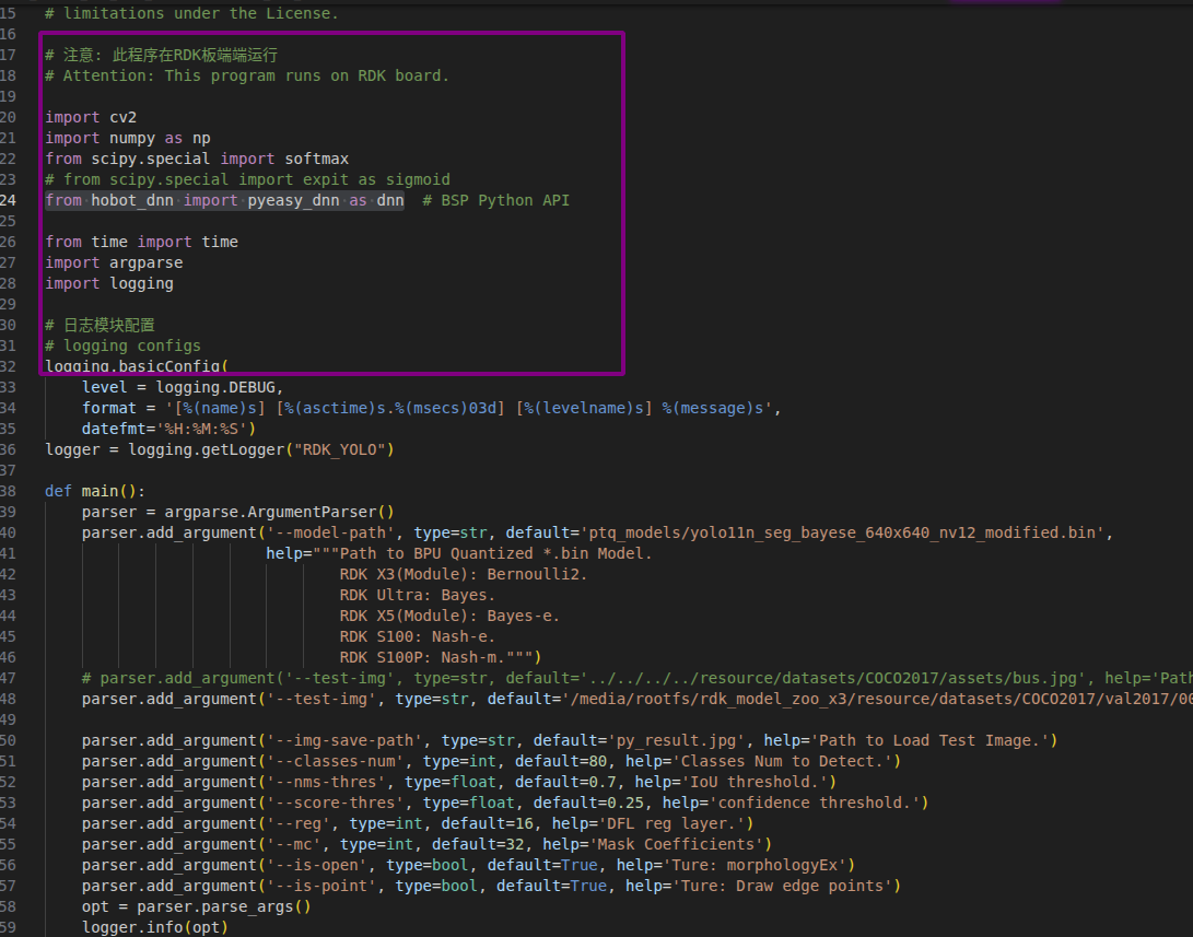

2026-04-21 18:22:21,469 file: hb_mapper_makertbin.py func: hb_mapper_makertbin line No: 784 End Model Convert
您好,建议优先将校准方法由 max 切换为 kl 或启用自动搜索,并增加校准数据的多样性,若精度仍不足,则通过节点级分析定位 Segmentation 分支的敏感算子并配置为 INT16 或 CPU 运行。参考链接:
感谢提供的建议 校验后继续进行反馈。我请教一个问题,目前测试的中间产物*_quantized_model.onnx的效果与原始的.onnx模型效果相差不大。但是将最终产物.bin模型部署到板端测试,效果相差很大,这种现象是正常的吗?需要怎么定位?根据文档,*_quantized_model.onnx与.bin模型的效果应该基本一致才对。
补充一下:我使用的 python脚本做的推理效果测试,是需要用C++做推理吗?
官方提供的说明文档也是这么说明的:
使用工具hb_verifier对比*_quantized_model.onnx与.bin模型,也是会提示严重不符
这是原始模型onnx最后这段语义的结构,有什么改进的建议吗?麻烦提供一下指导
板端的python脚本? 板端的话需要使用 hbm_runtime这个库,最新的3.5.0的镜像
手册3.6章节 BPU 算法接口手册 | RDK DOC

    • 特别是 ScatterNDWhere:这些算子在 CPU 上运行浮点逻辑,对输入数据的精度极其敏感。如果前一级 BPU 传过来的 int8 数据在反量化时丢失了低位信息,Equal 比较就会出错,导致 ScatterND 写入错误的位置,最终导致分割结果完全错乱(均值/方差剧烈变化)。

好的 感谢提供的建议 我梳理对比一下
根据你的日志和现象,这是典型的 CPU/BPU 异构量化误差累积问题。*_quantized_model.onnx 是理想量化模拟,.bin 是板端实际运行,两者在 BPU<->CPU 切换时的反量化/重量化逻辑差异会导致误差累积。
:magnifying_glass_tilted_left: 问题定位步骤
1. 使用 hb_verifier 分阶段对比
# 分 Subgraph 对比,定位误差来源
hb_verifier \
  --original_model lraspp_99_torch110.onnx \
  --quantized_model lraspp_99_torch110_3_quantized_model.onnx \
  --bin_model lraspp_99_torch110_3.bin \
  --calibration_data ../hb_calibration_data1_f32 \
  --layer_wise_compare \
  --output_dir verifier_output
重点关注输出中 Cosine Similarity 骤降 的层,通常是 BPU->CPU 或 CPU->BPU 的切换点。

这啥意思 我直接使用的是from hobot_dnn import pyeasy_dnn as dnn 这个推理的,官方提供的zoo样例 yolo11-seg里面也是在板端用这个来做推理的,我是RDK-X5的设备
你好,原接口对featuremap兼容不好,所以推出了接口

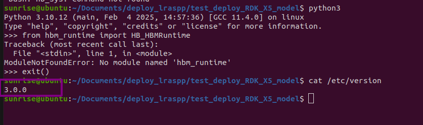

您的意思是 我需要更新板子的版本到 3.5.0版本吗? 我当前板子安装的提供版本是3.0.0的版本
是的,你需要升级到 RDK OS 3.5.0 版本。

3.0.0 hobot_dnn :cross_mark: 兼容性问题多 不推荐用于复杂输入
3.5.0 hbm_runtime :white_check_mark: 完整支持 推荐使用

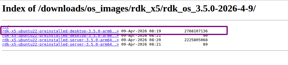

3.5 0有新的python 接口提供,如果使用C接口也不确认是否更目前工具链对应,3.0.0应该是很久之前的系统了
1 个赞
3.5最新的版本我看官网是 04-09号的版本?是指这个版本吗?
是的,就是这个版本!rdk-x5-ubuntu22-preinstalled-desktop-3.5.0-arm64... 是正确的。
:white_check_mark: 版本选择建议
镜像文件 适用场景 推荐
desktop 版本 带桌面环境,方便调试 :star: 推荐(开发阶段)
server 版本 无桌面,资源占用少 部署阶段
你截图中的 desktop 版本 适合开发调试,直接使用即可。
:clipboard: 升级前准备
# 1. 备份当前板子上的重要数据
scp -r ~/your_project user@backup_server:/backup/path
# 2. 下载镜像(约 2.7GB)
wget https://downloads.os.horizon.ai/rdk_x5/rdk_os_3.5.0-2026-4-9/rdk-x5-ubuntu22-preinstalled-desktop-3.5.0-arm64.img.xz
# 3. 解压
unxz rdk-x5-ubuntu22-preinstalled-desktop-3.5.0-arm64.img.xz
:wrench: 烧录步骤
# 1. 插入 SD 卡,查看设备名
lsblk  # 确认 SD 卡设备,如 /dev/sdb
# 2. 烧录(⚠️ 确认设备名,避免误操作)
sudo dd if=rdk-x5-ubuntu22-preinstalled-desktop-3.5.0-arm64.img of=/dev/sdX bs=4M status=progress
# 3. 同步并弹出
sync && sudo eject /dev/sdX
:white_check_mark: 升级后验证
# 1. 检查系统版本
cat /etc/version  # 应显示 3.5.0
# 2. 验证 hbm_runtime 可用
python3 -c "from hbm_runtime import HB_HBMRuntime; print('hbm_runtime OK')"
# 3. 验证模型推理
python3 your_inference_script.py
:warning: 注意事项
  1. 升级后需要重新配置环境(Python 包、项目代码等)
  2. 建议先在测试板上验证,确认无误后再部署到生产板
  3. 保留 3.0.0 的 SD 卡作为备份,方便回退
升级完成后,用 hbm_runtime 重新测试你的模型,精度问题应该会有明显改善。有进展随时反馈!
目前RDK系统由3.0.0升级到3.5.0版本后,板端部署的精度与*_quantized_model.onnx**量化模型精度基本一致;核心问题在于:**当前系统版本是初始版本,对于featuremap数据的输入支持比较差
恭喜问题解决!:tada: 这是一个非常典型的系统版本兼容性导致精度异常的案例。
:pushpin: 问题根因总结
环节 现象 根因
ONNX → quantized_model.onnx :white_check_mark: 精度正常 x86 上 ONNX Runtime 模拟量化,逻辑正确
quantized_model.onnx → .bin :cross_mark: 精度失真 RDK OS 3.0.0 的 hobot_dnnfeaturemap 多通道输入支持不完善
升级 3.5.0 后 :white_check_mark: 精度恢复 hbm_runtime 完整支持 featuremap 输入格式
:wrench: 后续优化建议
虽然精度已对齐,但日志显示 segmentation 输出的 Cosine Similarity = 0.987 仍有提升空间,可继续优化:
1. 校准策略优化
calibration_parameters:
  calibration_type: 'kl'  # 从 max 改为 kl
  per_channel: True
  # 校准数据增加到 200-500 张,覆盖更多场景
  cal_data_dir: '../hb_calibration_data_enhanced_f32'
2. 敏感算子配置
如果精度仍需提升,可尝试将语义分割分支的关键算子强制为 int16
model_parameters:
  node_info: {
    "Conv_170": {'ON': 'BPU', 'InputType': 'int16', 'OutputType': 'int16'},
    "Conv_171": {'ON': 'BPU', 'InputType': 'int16', 'OutputType': 'int16'},
    "Sigmoid_230": {'ON': 'BPU', 'InputType': 'int16', 'OutputType': 'int16'},
