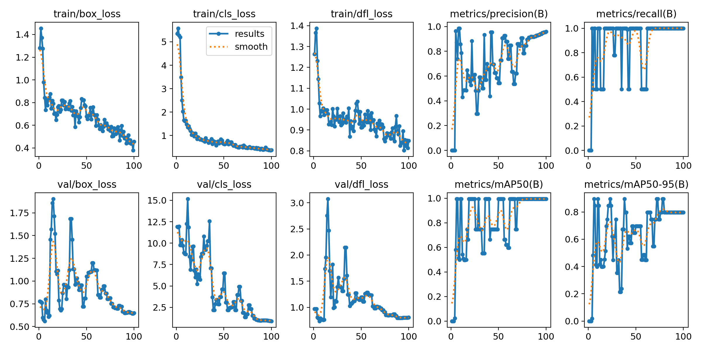

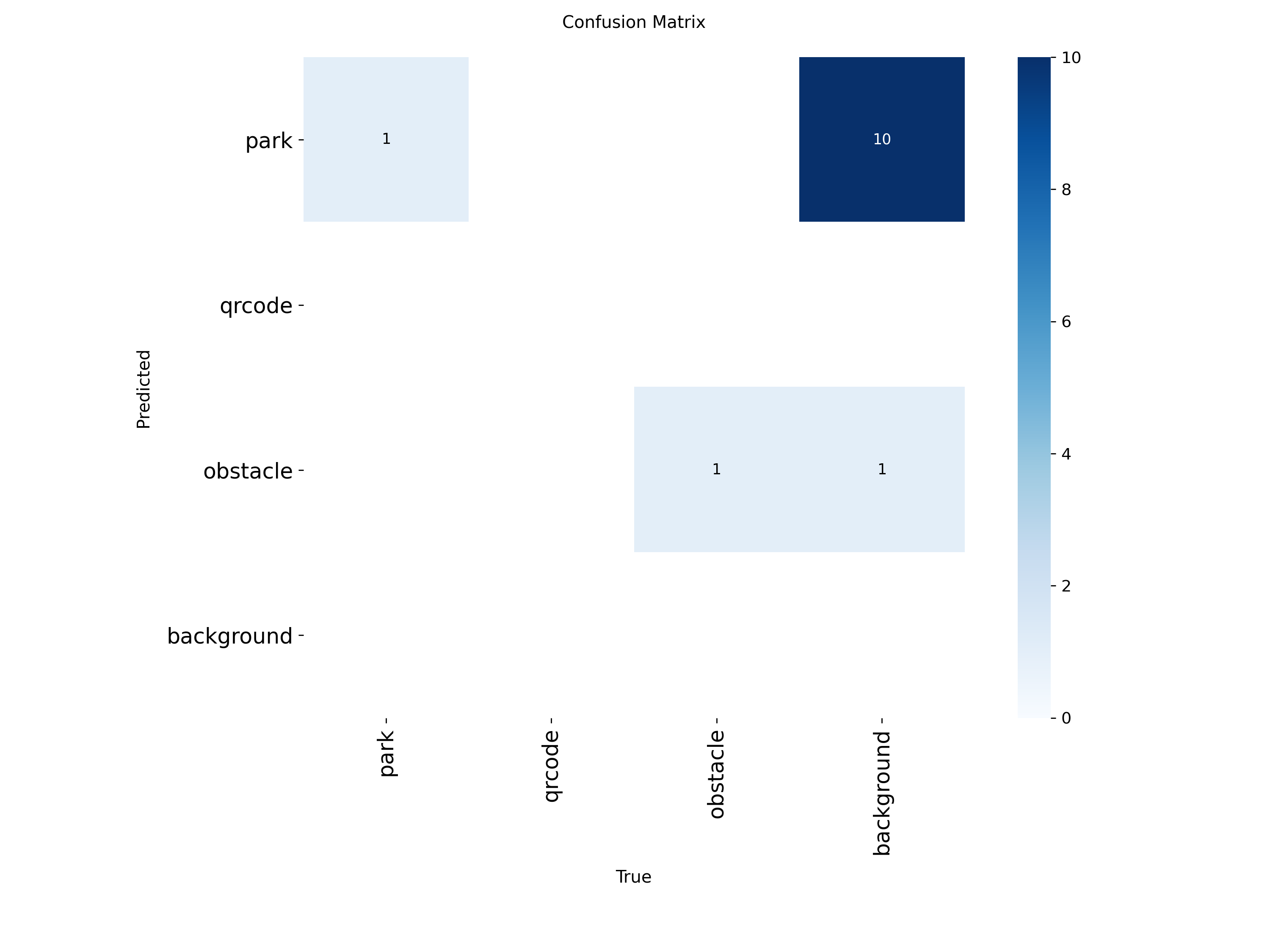

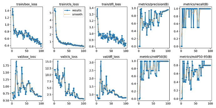

训练命令:
yolo detect train model=yolo11s.pt data=dataset/data.yaml epochs=100 imgsz=640 \
  batch=16 device=0 project=runs name=yolov11s_park exist_ok=True
训练完成日志:
100 epochs completed in 0.044 hours.
YOLO11s summary (fused): 101 layers, 9,413,961 parameters, 21.3 GFLOPs
                 Class     Images  Instances     Box(P    R   mAP50  mAP50-95)
                  all          8          2     0.845    1   0.995    0.895
                  park          1          1     0.734    1   0.995    0.995
              obstacle          1          1     0.957    1   0.995    0.796
3 分钟训完,mAP50 = 0.995,mAP50-95 = 0.895,best.pt 19 MB。
