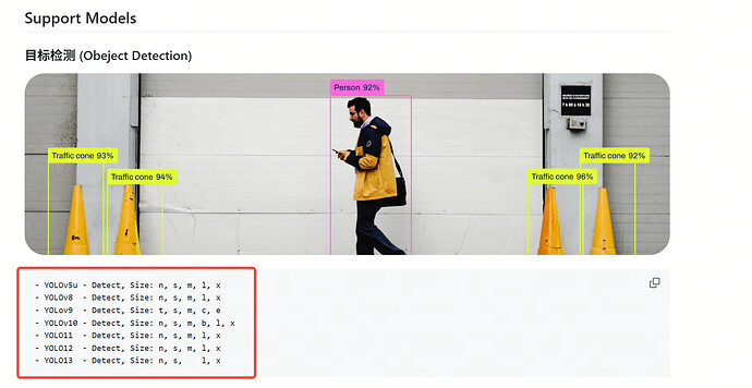

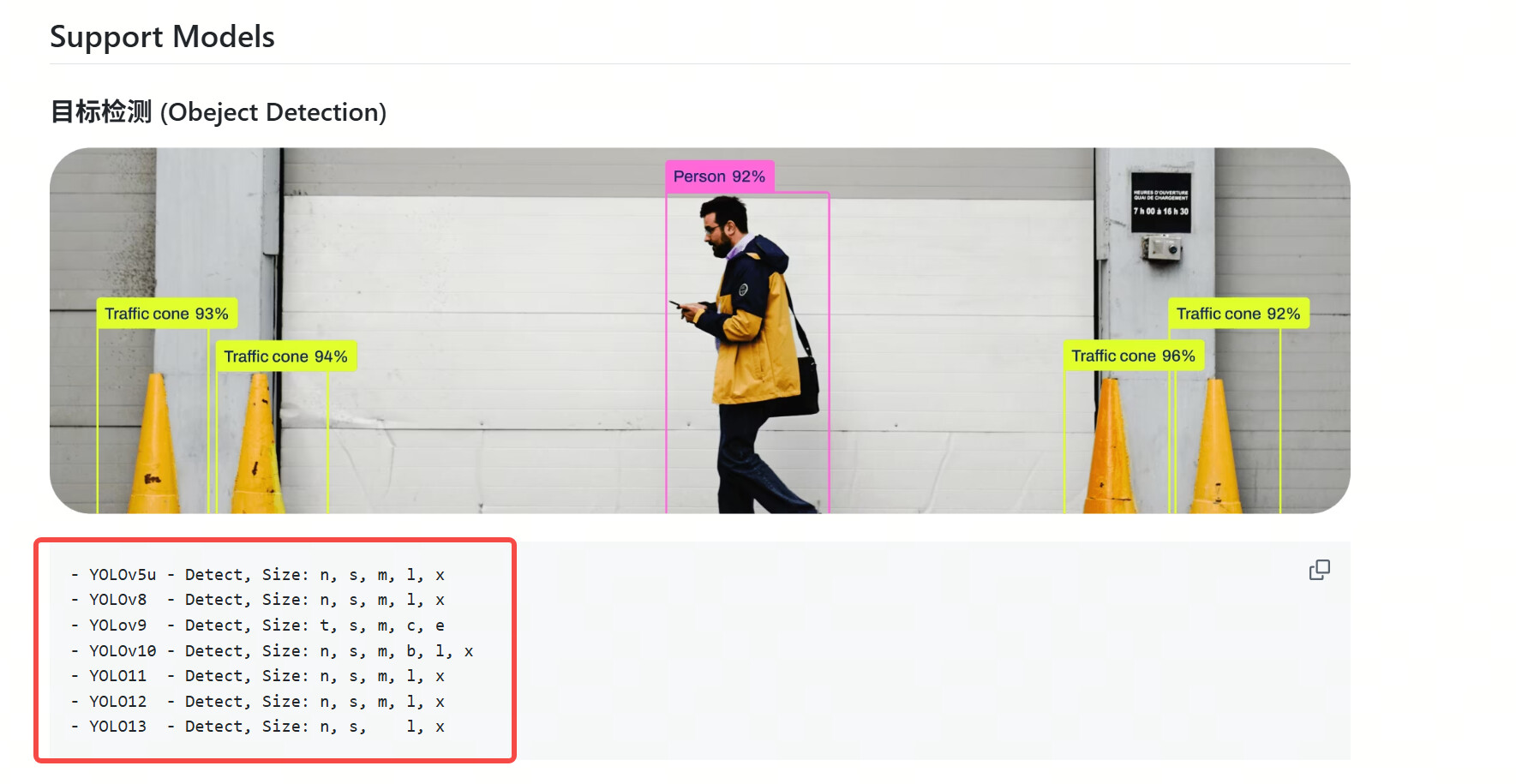

你好,请仔细阅读readme:
https://github.com/D-Robotics/rdk_model_zoo/blob/main/samples/vision/ultralytics_yolo/README_cn.md#support-models
