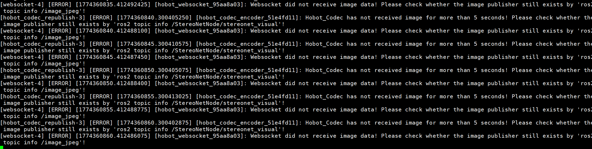

132gs 模组双目深度问题
测试双目深度算法,执行bash run_stereo.sh --stereonet_version v2.4 之后报错

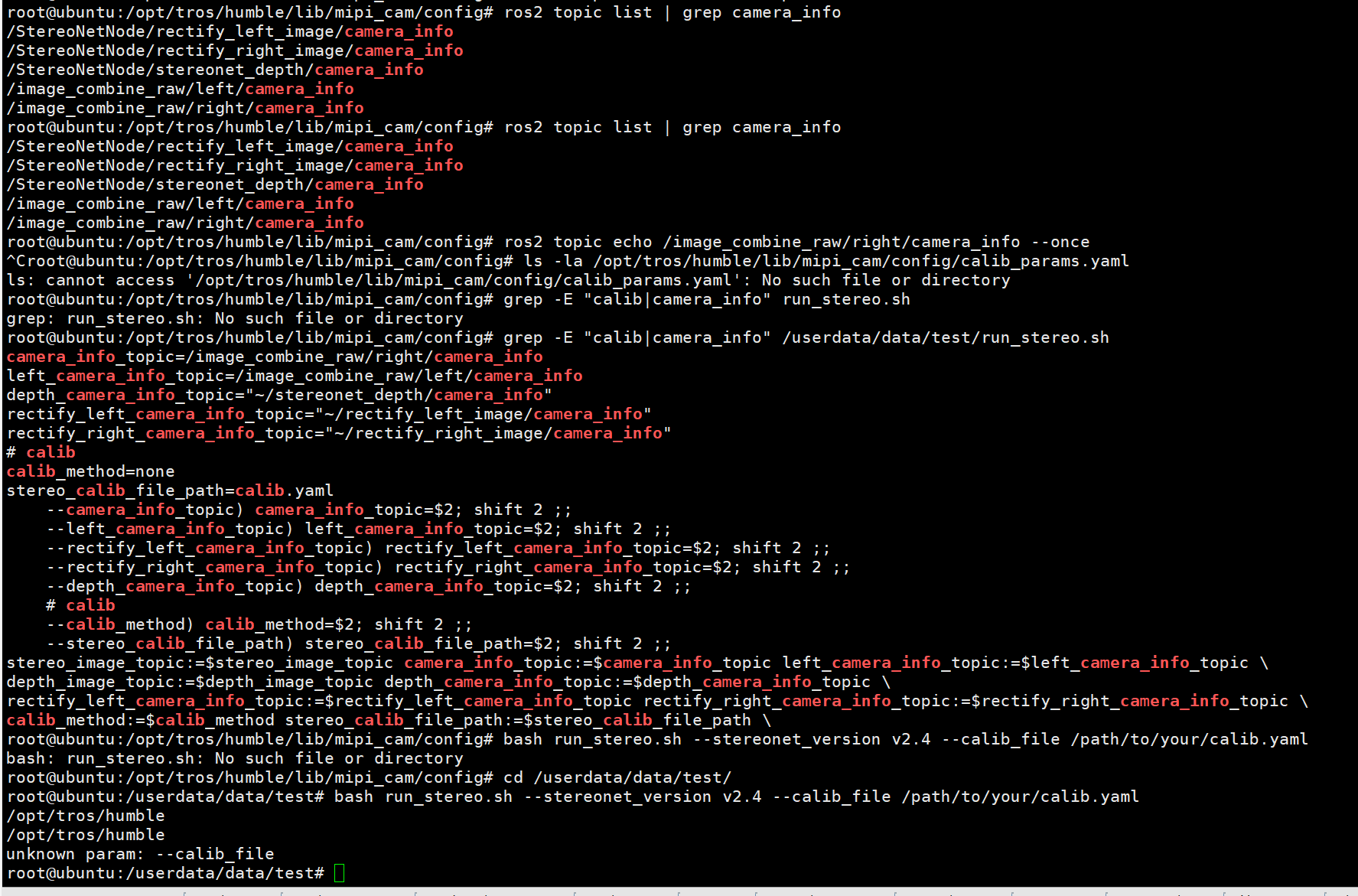

方案 1:检查并配置标定文件(最可能)
# 1. 检查标定文件是否存在
ls -la /data/camera_calib/
# 或
ls -la /userdata/data/camera_calib/
# 2. 如果没有标定文件,需要从相机模组获取或重新标定
# 132GS 模组通常自带标定文件,检查模组包装或联系供应商
# 3. 运行双目算法时指定标定文件路径
bash run_stereo.sh --stereonet_version v2.4 --calib_file /data/camera_calib/your_calib.yaml

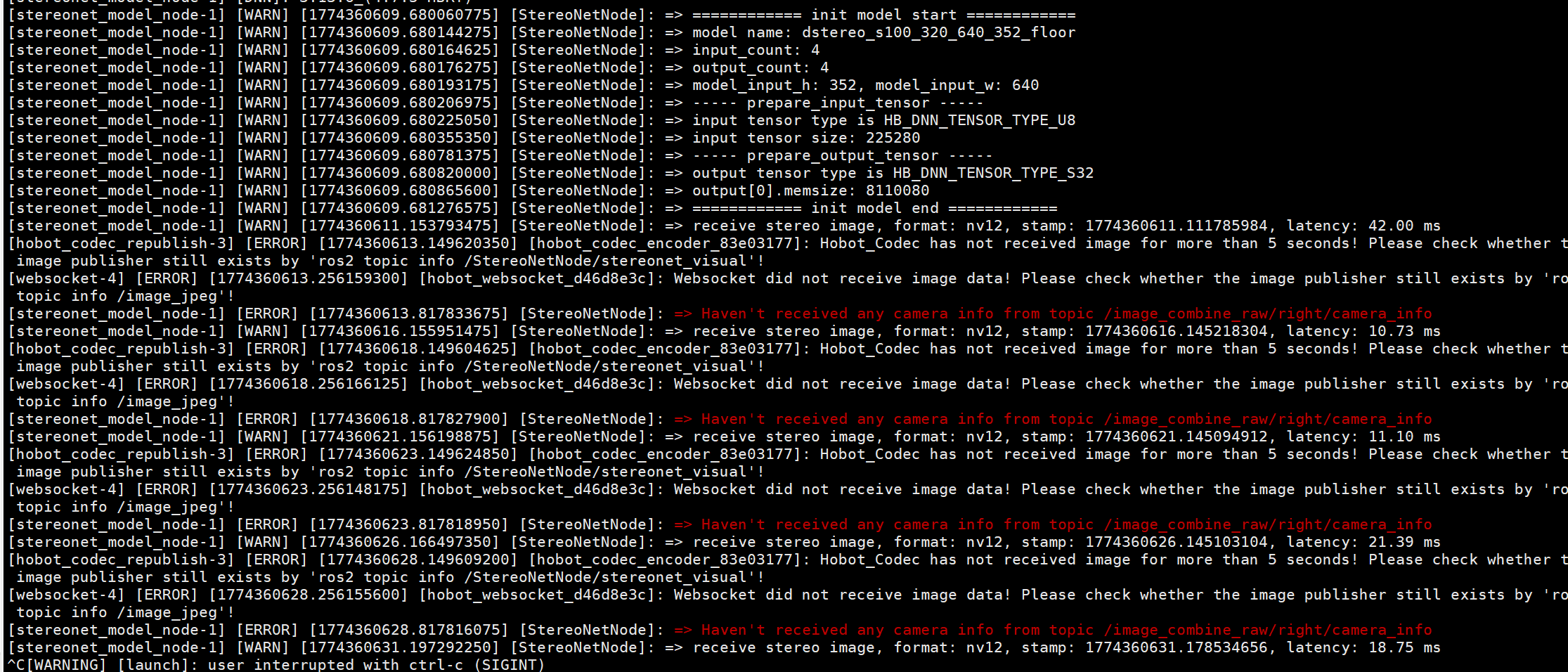

Ubuntu 22.04.5 LTS \n \l。
官方sc132gs 套件
root@ubuntu:/userdata/data/test# bash run_stereo.sh --stereonet_version v2.4

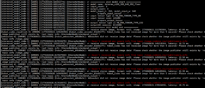

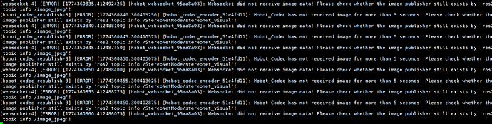

[stereonet_model_node-1] [ERROR] [1774360945.664718325] [StereoNetNode]: => Haven’t received any camera info from topic /image_combine_raw/right/camera_info
[stereonet_model_node-1] [WARN] [1774360946.634962950] [StereoNetNode]: => receive stereo image, format: nv12, stamp: 1774360946.615449856, latency: 19.51 ms
^C[WARNING] [launch]: user interrupted with ctrl-c (SIGINT)
[stereonet_model_node-1] [INFO] [1774360948.176919775] [rclcpp]: signal_handler(SIGINT/SIGTERM)
[stereonet_model_node-1] [WARN] [1774360948.254085200] [StereoNetNode]: => release StereoNetNode
[stereonet_model_node-1] [WARN] [1774360948.258693650] [StereoNetNode]: => release StereonetProcess
[INFO] [hobot_codec_republish-3]: process has finished cleanly [pid 6177]
[INFO] [websocket-4]: process has finished cleanly [pid 6179]
[stereonet_model_node-1] sh: 1: �$��-b: not found
[INFO] [stereonet_model_node-1]: process has finished cleanly [pid 6173]
root@ubuntu:/userdata/data/test# ros2 topic list
/image_combine_raw
/image_left_raw
/image_right_raw
/parameter_events
/rosout
:bullseye: 问题进展:StereoNet 已启动,但缺少相机标定信息
从最新日志看,问题已经解决了一大半!
:white_check_mark: 已正常工作的部分
  • StereoNet 节点成功启动
  • 能够接收双目图像:receive stereo image, format: nv12
  • 图像话题正常:/image_combine_raw, /image_left_raw, /image_right_raw
:cross_mark: 剩余问题
[ERROR] [StereoNetNode]: Haven't received any camera info from topic
缺少相机标定信息,导致无法计算深度。

:bullseye: 问题明确:缺少相机标定文件
从截图看,StereoNet 节点已启动并能接收图像,但没有相机标定参数导致无法计算深度。
:white_check_mark: 解决方案

root@ubuntu:/userdata/data/test# find / -name “*.yaml” 2>/dev/null | grep -i calib
/opt/tros/humble/lib/mipi_cam/config/F37_calibration.yaml
/opt/tros/humble/lib/mipi_cam/config/SC230ai_dual_calibration.yaml
/opt/tros/humble/lib/mipi_cam/config/GC4663_calibration.yaml
root@ubuntu:/userdata/data/test# ros2 topic list | grep camera_info
/StereoNetNode/rectify_left_image/camera_info
/StereoNetNode/rectify_right_image/camera_info
/StereoNetNode/stereonet_depth/camera_info
/image_combine_raw/left/camera_info
root@ubuntu:/userdata/data/test# grep -E “calib|camera_info|render_type” run_stereo.sh | head -20
camera_info_topic=/image_combine_raw/right/camera_info
left_camera_info_topic=/image_combine_raw/left/camera_info
depth_camera_info_topic=“~/stereonet_depth/camera_info”
rectify_left_camera_info_topic=“~/rectify_left_image/camera_info”
rectify_right_camera_info_topic=“~/rectify_right_image/camera_info”
calib
calib_method=none
stereo_calib_file_path=calib.yaml
render_type=“distance”
–camera_info_topic) camera_info_topic=$2; shift 2 ;;
–left_camera_info_topic) left_camera_info_topic=$2; shift 2 ;;
–rectify_left_camera_info_topic) rectify_left_camera_info_topic=$2; shift 2 ;;
–rectify_right_camera_info_topic) rectify_right_camera_info_topic=$2; shift 2 ;;
–depth_camera_info_topic) depth_camera_info_topic=$2; shift 2 ;;
calib
–calib_method) calib_method=$2; shift 2 ;;
–stereo_calib_file_path) stereo_calib_file_path=$2; shift 2 ;;
–render_type) render_type=$2; shift 2 ;;
stereo_image_topic:=$stereo_image_topic camera_info_topic:=$camera_info_topic left_camera_info_topic:=$left_camera_info_topic
depth_image_topic:=$depth_image_topic depth_camera_info_topic:=$depth_camera_info_topic
:bullseye: 问题已定位!标定配置错误
从你的诊断信息看,关键问题找到了:
:cross_mark: 当前配置问题
calib_method=none              # 标定方法设为 none,不读取标定
stereo_calib_file_path=calib.yaml  # 相对路径,文件不存在
:white_check_mark: 可用资源
  • camera_info 话题正常发布(5 个相关话题)
  • 有 SC230ai 的标定文件参考:/opt/tros/humble/lib/mipi_cam/config/SC230ai_dual_calibration.yaml
  • 但没有 SC132GS 的专用标定文件

:warning: 剩余警告(不影响深度计算)
Hobot_Codec has not received image for more than 5 seconds
Websocket did not receive image data
这是可视化编码节点的问题,不影响深度算法本身,通常是:
  • 浏览器未访问 http://<IP>:8000 查看画面
  • 或 codec 节点配置问题
