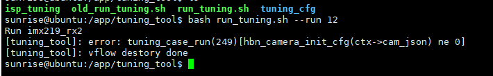

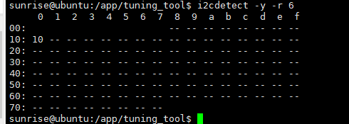

imx219 在x5平台进入不了tuning模式,报错误。i2c可以找到,能正常出图。
版本是3.3.3

问题原因: tuning 工具找不到或无法正确加载 IMX219 的配置文件(cam_json)。
请先排查:
检查配置文件是否存在:
ls -la /app/tuning_tools/tuning_cfg/
find /app -name "*imx219*.json"
x5的文件名是这种了。有imx219的 json文件
您好,IMX219不在这个脚本的支持列表里:
# bash run_tuning.sh --list
index: 4  sensor_name: sc132gs-1280p            config_file:linear_1088x1280_raw10_30fps_1lane.c
index: 5  sensor_name: sc035hgs                 config_file:linear_640x480_raw10_30fps_1lane.c
index: 6  sensor_name: ov5640                   config_file:linear_1920x1080_raw10_30fps_2lane.c
index: 7  sensor_name: f37                      config_file:linear_1920x1080_raw10_30fps_1lane.c
index: 8  sensor_name: imx415-30fps-2lane       config_file:linear_3840x2160_raw10_30fps_2lane.c
index: 9  sensor_name: imx415-30fps-4lane       config_file:linear_3840x2160_raw10_30fps_4lane.c
index: 10  sensor_name: sc202cs-1600x1200       config_file:linear_1600x1200_raw10_30fps_1lane.c
index: 11  sensor_name: irs2381c-tof            config_file:linear_224x1903_raw12_5fps_2lane.c
index: 12  sensor_name: sc035hgs-vc0            config_file:linear_640x480_raw10_30fps_2lane_vc0.c
index: 13  sensor_name: sc035hgs-vc1            config_file:linear_640x480_raw10_30fps_2lane_vc1.c
index: 14  sensor_name: sc231ai-30fps           config_file:linear_1920x1080_raw10_30fps_2lane.c
index: 15  sensor_name: imx586-30fps-4lane      config_file:linear_3840x2160_raw10_30fps_4lane.c
index: 16  sensor_name: os08c10-30fps-2lane     config_file:linear_3840x2160_raw12_30fps_2lane.c
index: 17  sensor_name: ar0233-30fps            config_file:linear_1920x1080_raw12_30fps_2lane.c
index: 18  sensor_name: ar0820std-30fps         config_file:linear_3840x2160_yuv422_30fps_4lane.c
index: 19  sensor_name: sc1336                  config_file:linear_1280x720_raw10_15fps_2lane.c
index: 20  sensor_name: dummy                   config_file:dummy_sensor.c
这块具体的手册可以参考buildroot的sdk芯片手册 1.7 下载资源汇总 | RDK DOC

tuning_case_run(249)[hbn_camera_init_cfg(ctx->cam_json) ne 0]
虽然 I2C 能正常通信并出图,但 tuning 工具无法加载 IMX219 的配置文件(cam_json),导致启动失败。
管理员 Marcelo 已确认:
当前 run_tuning.sh 脚本的内置支持列表中 不包含 IMX219。因此即使存在 .json 配置文件,工具也无法识别并调用它。
